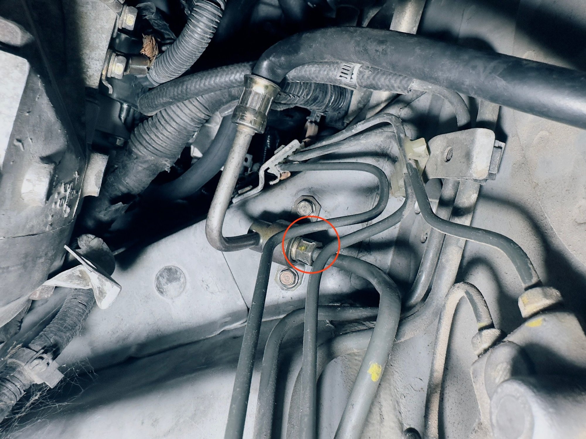

Originally Posted by flanders
No need to take the manifold off, that's crazy amount of work. You can reach the lower connection from under the car and wiggle the whole hose out.
Be aware that nut may need crazy amount of force to be loosened so use a quality 14mm tool, preferably something like I use in the picture.

Default Can’t get that bolt loose! Tried everything!!! Help!!!!!!!

Are you using a flare nut wrench like in picture?
Soak with pb blaster or similar and let it sit.
Could also try ad some heat, be really careful though since there is fuel inside. No torch, just a heat gun or something similar.
I was thinking the pipe would break before I got mine loose, it was crazy tight.

Flanders is right, you need this special kind of flare nut wrenches for these nuts, otherwise you are asking ..no... yelling for trouble.
Now soak it in your favorite PB blaster or similar oil, use patience, a litte bit of heat and locking pliers. Good luck!
