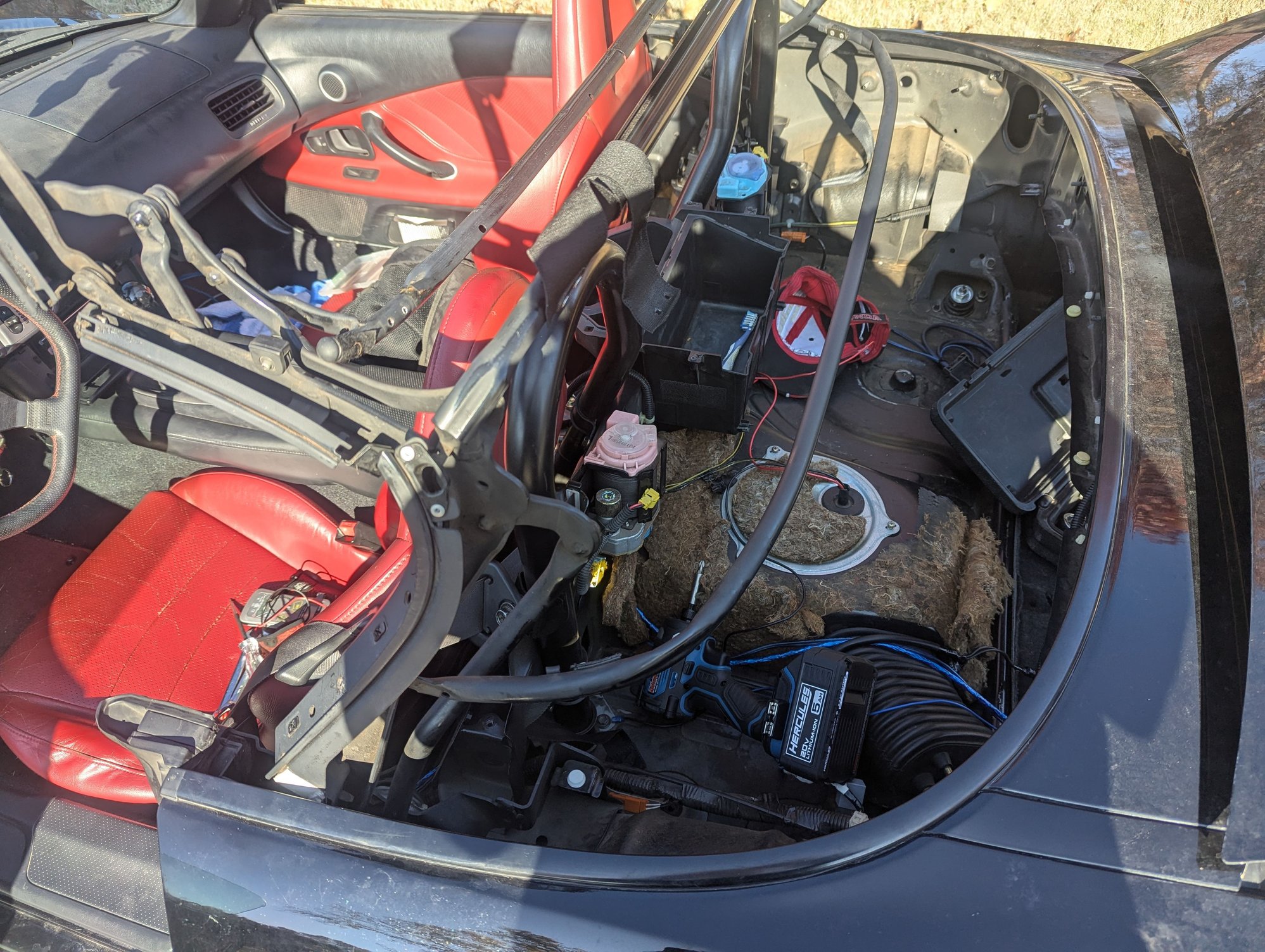

I had to leave my S in my friend's neighborhood overnight with no top on it. Made me slightly nervous, but nothing happened thankfully.
No top = easy access. I'm actually pretty lucky that this happened while I have my Robbins top out to re-glue the rear window.

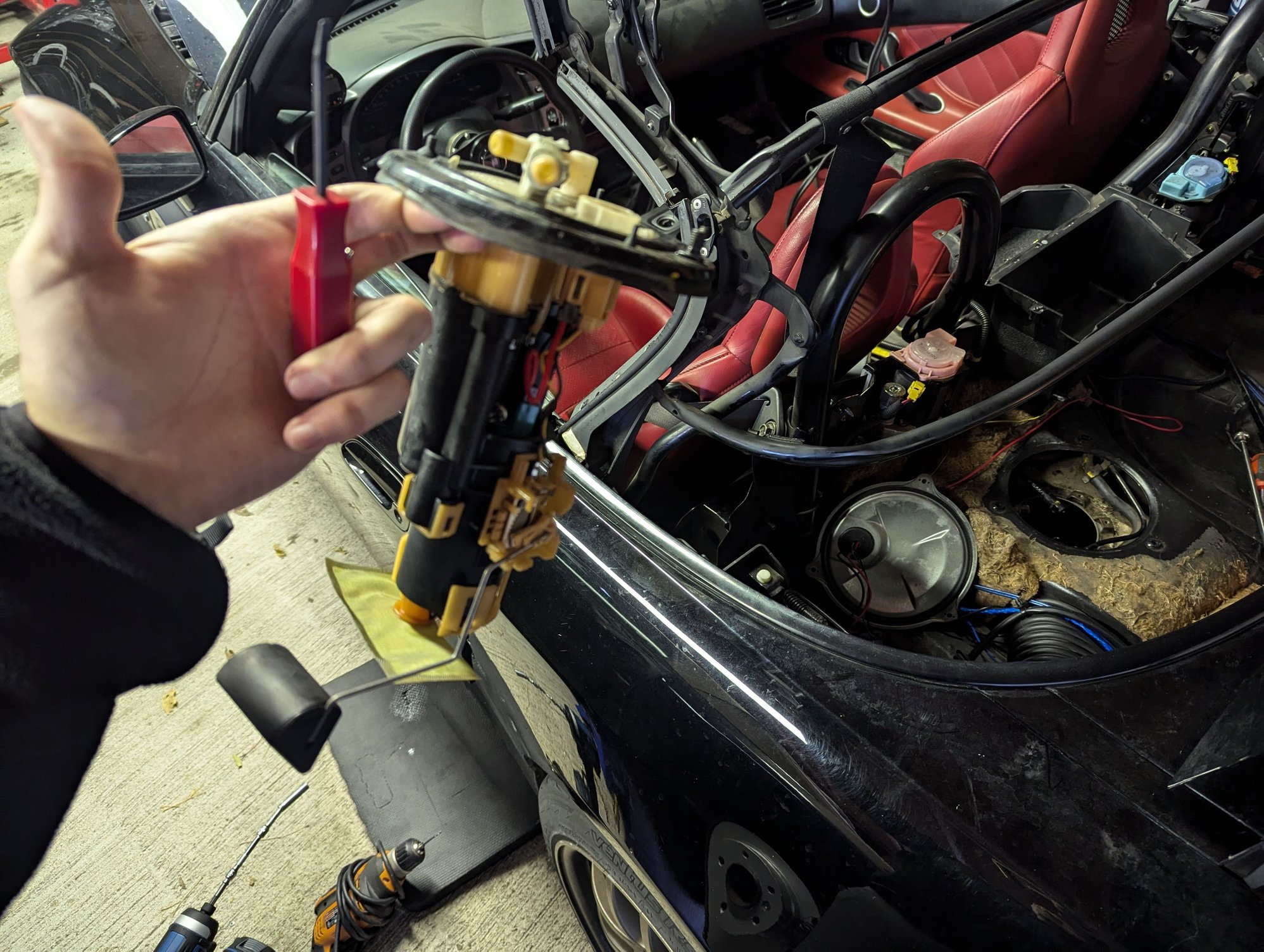

Fuel pump out the first time. Nothing seemed out of the ordinary. Tested voltage and it was getting 12.7V during key-on.
All the connections seemed to be fine although I didn't tug on the wires. I put it back and hooked up a battery to help it get full power and the S started up, so I drove it straight home.

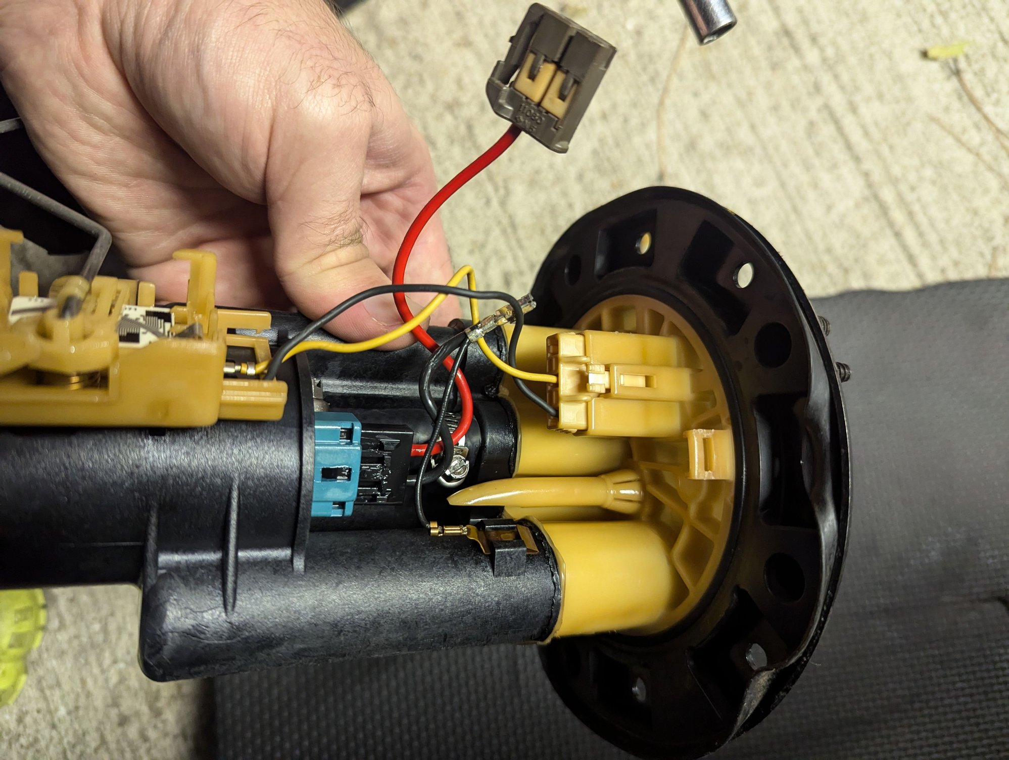

Second time pulling out the fuel pump housing.
The Black ground wire came out of the connector when I gave it a nudge. It was loose in there. I ended up taking that off and re-crimping a new terminal on to help the two wires fit in the connector housing better.

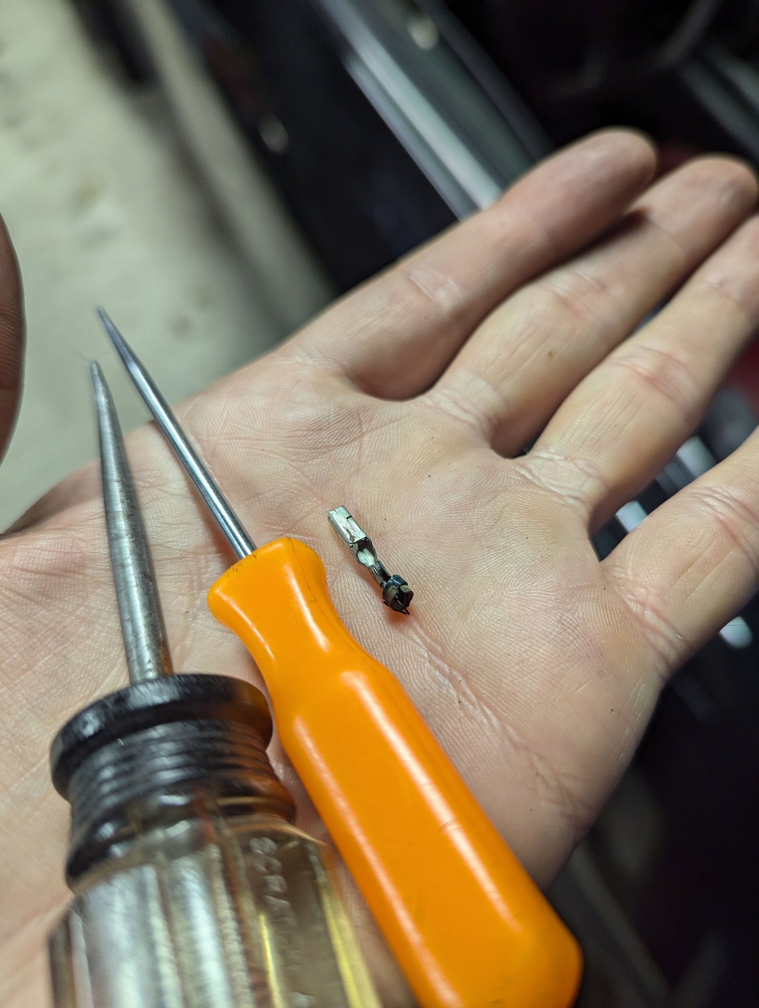

Everything looks normal here. I decided I was going to depin all the connectors though
Tada! It just popped right out whenever I got the cover off. That seems like a big problem. I'm really glad it didn't start moving around and sparking.
This is why it is important to learn how to properly use wiring tools and install terminals securely. I have since improved my crimp game. You know what they say, crimpin' ain't easy. lol
