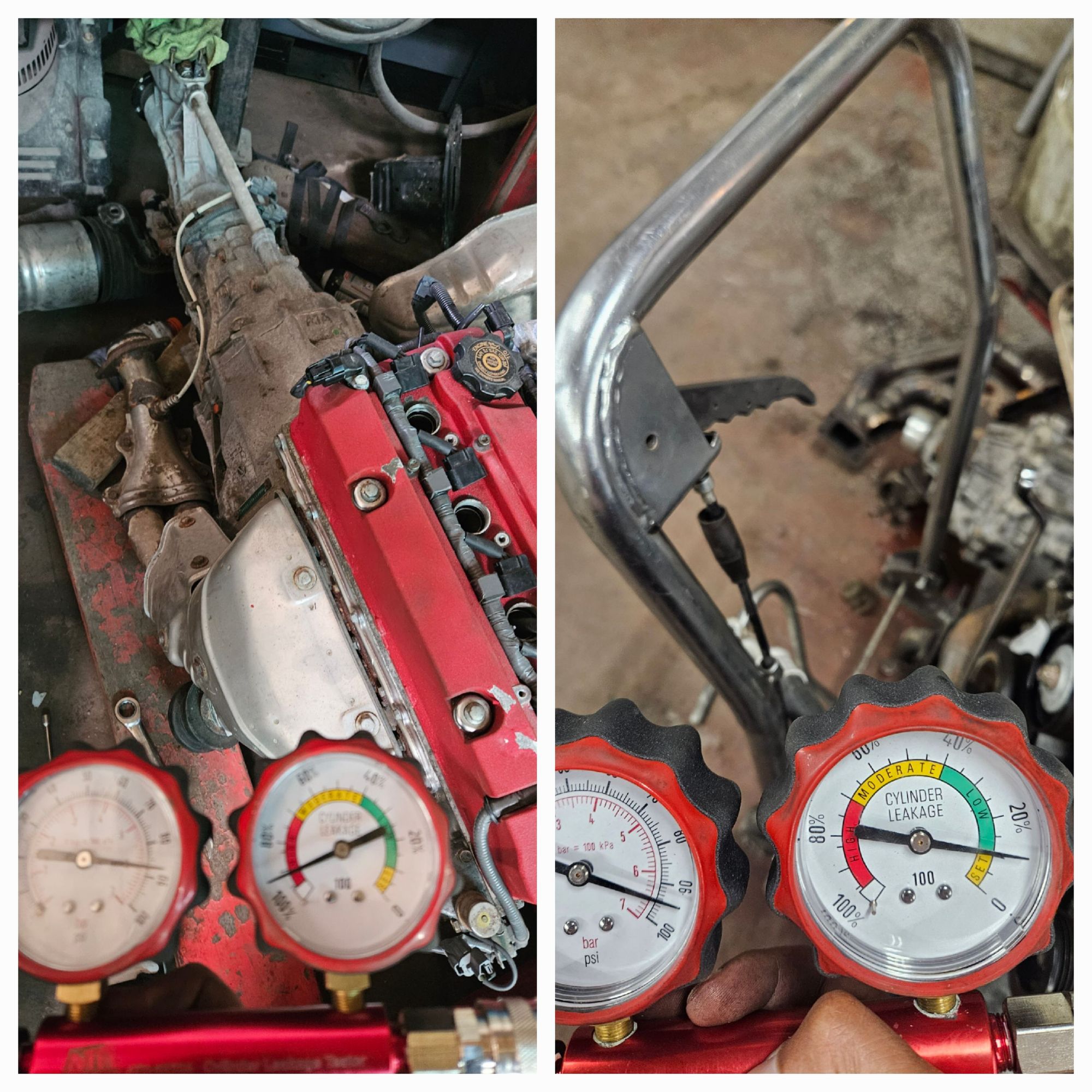

Seems like everything turned out OK. I torqued everything to spec and spun the motor a few times. Thank you for the help. Here is a before and after @Billman250 . I bought this engine from a car that was involved in a Florida hurricane. It has only 7k miles on it. It had low compression and no start situation. Ended up having 12 bent valves. Luckily the rods checked out ok. On 2 of the cylinders the piston just shot down as soon as I hooked up the tester. I guess that shows pretty good sealing? I got the engine for $1700
