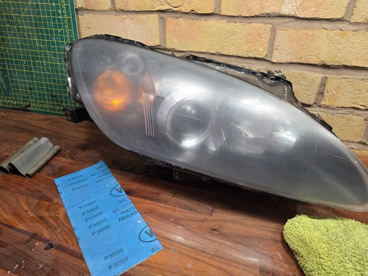

Starting to get nervous at 3000 that they would never clear up.

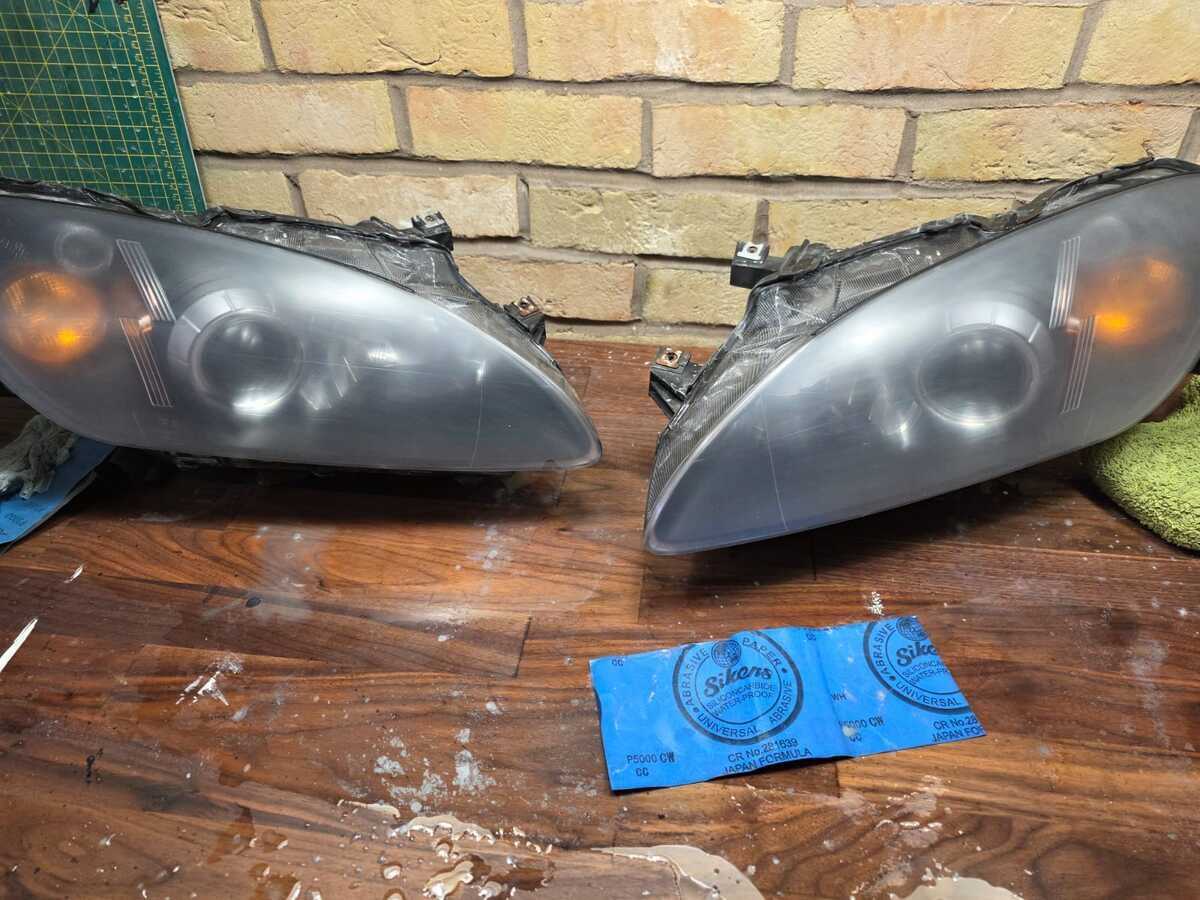

Still nervous at 5000.

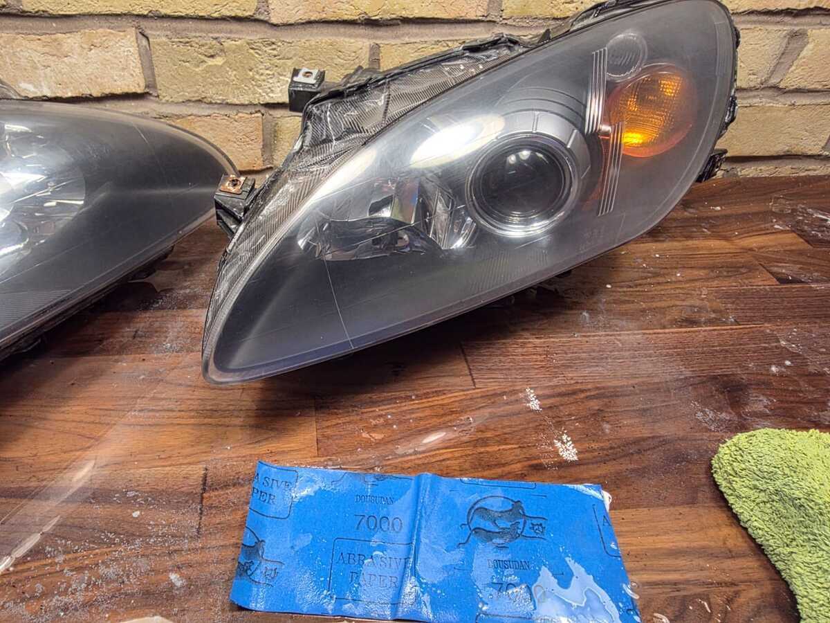

At 7000 they started looking noticeably clearer.

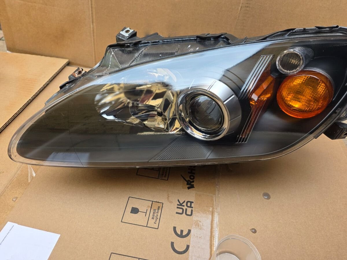

From 7000 to 10,000 they started to look great. But only after the clearcoat was applied did they start to look brand new.

Your job looks excellent! So are you saying that you used no polish before applying the clearcoat?

Yes. Straight from sanding, wipe clean with water, dry thoroughly, then clear coat.

Thanks for clarifying that. Is there a particular type of clear coat to go for?
