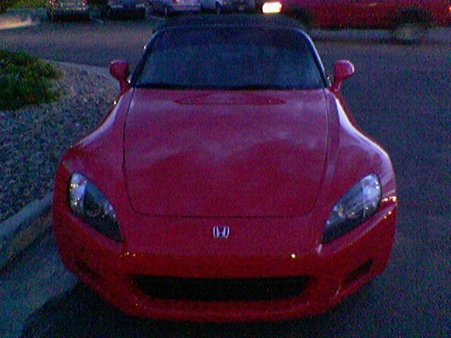

I put the whole thing in the oven, no towel, no bag, no nothing and did at 225 degrees and only for like 5-6 mins... whats with this hour thing? mine came out fine and just used lots of house hold silicone after the seperation of the two pieces and after i baked the second time. extra is good. Mine came out perfect!
BEFORE...
AFTER... I colored the clear bulbs with an orange Sharpie, they are bright orange when blinking they came out perfect and cost me less than 5$ total. No clear lense (diffuser was used I just removed the whole piece.) Thats up to you though the clear lense does look nice.
