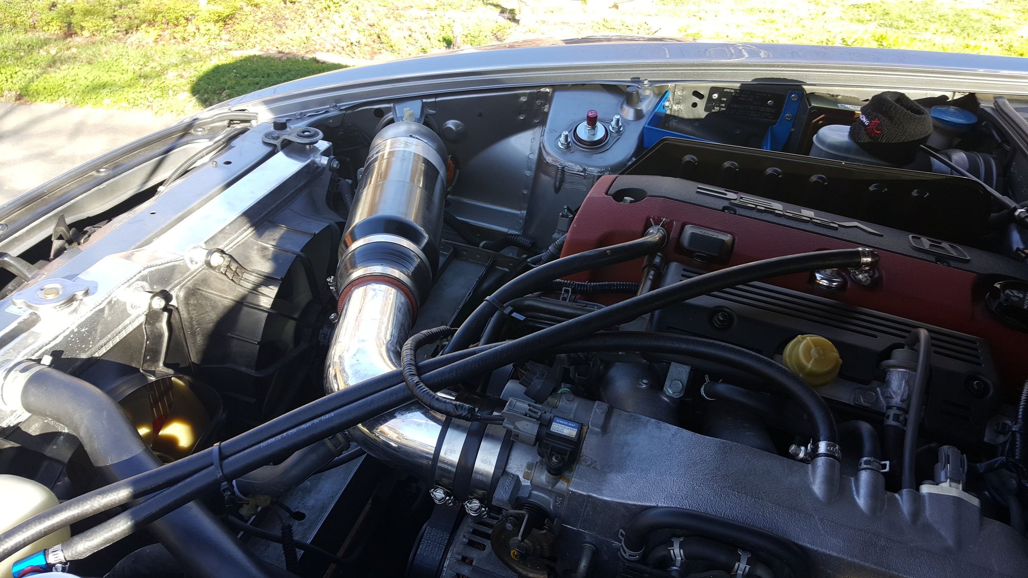

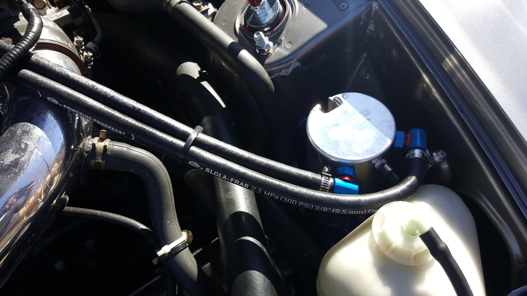

The catch can was installed after it started smoking/using excessive oil so I don't think it would be related to that?
