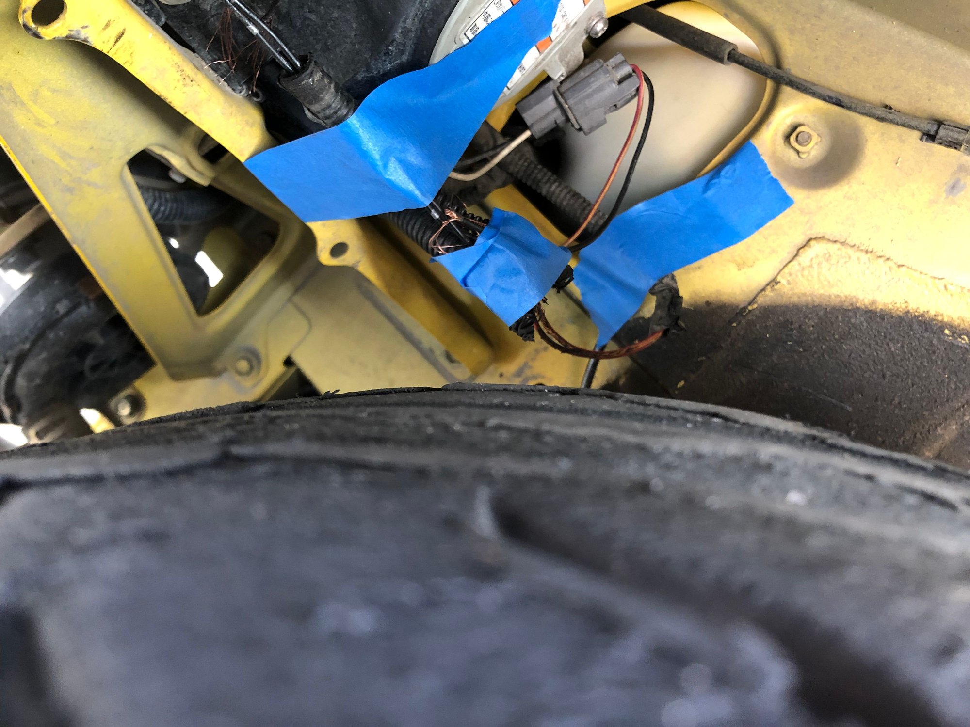

So I went to the track today, spun out on a rocky surface... not sure what happened to my car next but my turn signals, door lock, door remote, and cluster all does not work... Does anyone have any ideas? Could I of damage something big or is it just fuses or something. Pls help. Thanks!!
Update: I figured it out. The front left inner fender lining got ruin. It looks like the tire cut some of the wires near the headlight and turn light. It looks like I will need to take it to a tech for repair. Anyone have any ideas on how much this will run me? Thanks.

Either all the wores will need to be spliced (insert a new section of wire to replace the damaged sections, for each damaged wire, preferably soldered and heat shrink), or just buy that wiring harness from a wrecked car, and replace it yourself.

pic of the damage

Learn how to solder and tin wires,then repair,its quite rewarding.
