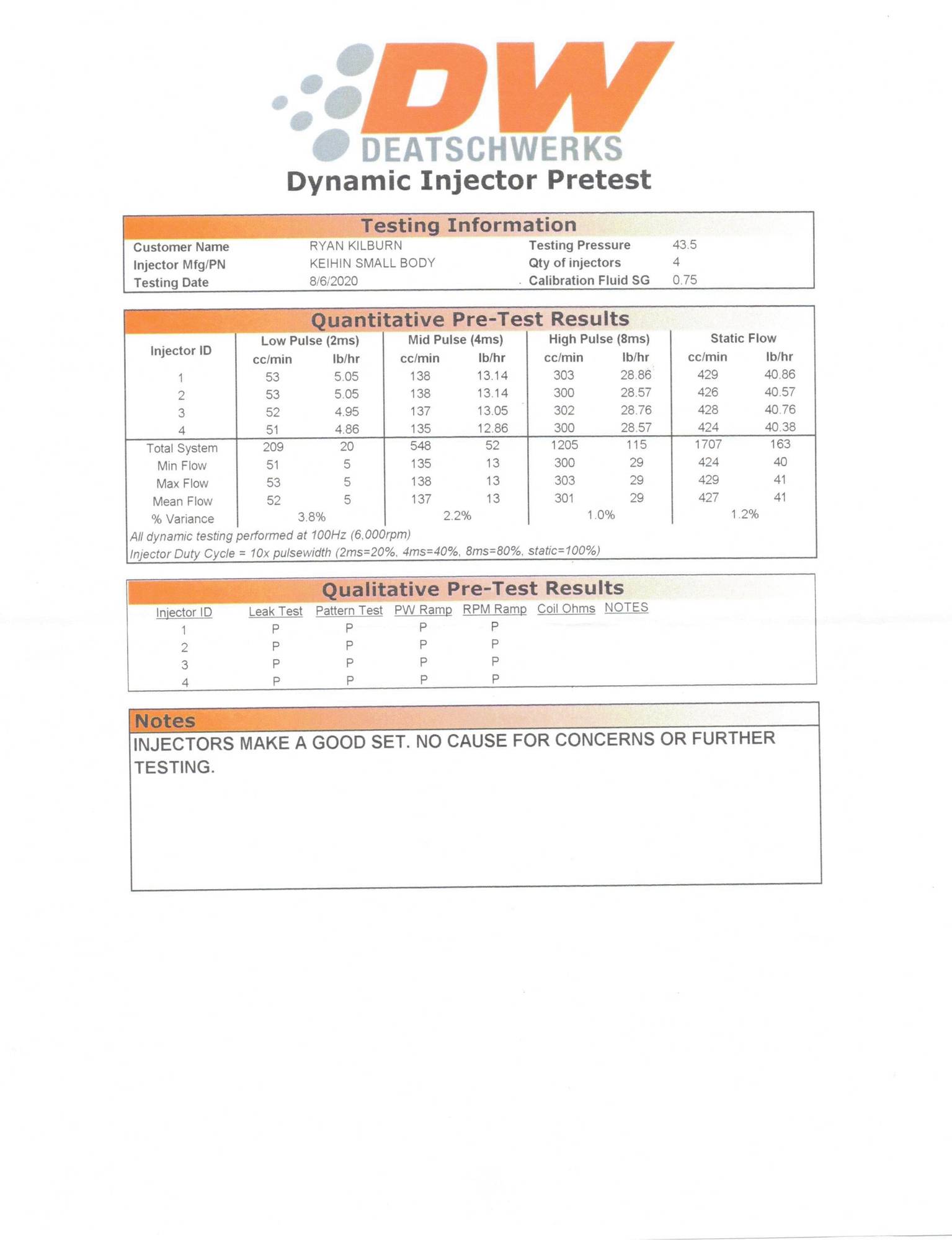

I sent my injectors off to Deatschwerks for cleaning and they came back fine with no need for cleaning. This is frustrating, but I will reinstall them and run the race fuel out of the car. Then I'll run the car to see if there are any improvements.
