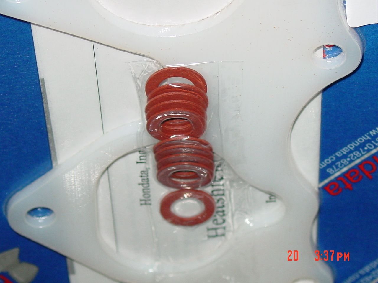

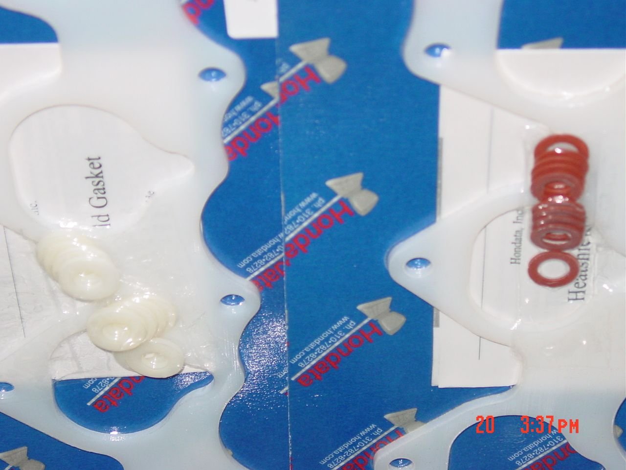

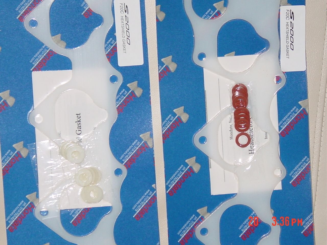

I think Hondata is aware of the washer issue. Received 4 gaskets last week, check out the supplied washers in one of the sets...
The red washers are thinner and don't seem like they will compress and deform like the white ones.

Not sure - probably Hondata starting to package "better" washers with the gaskets, and I happened to get a shipment of mixed inventory.
Now the choice is to use no washers, as prior installers have recommended, or to be a guinea pig with the new red washers...
Or we could all guinea pig it, I can probably get my hands on more of the red washers at Home Depot or an auto parts store.
