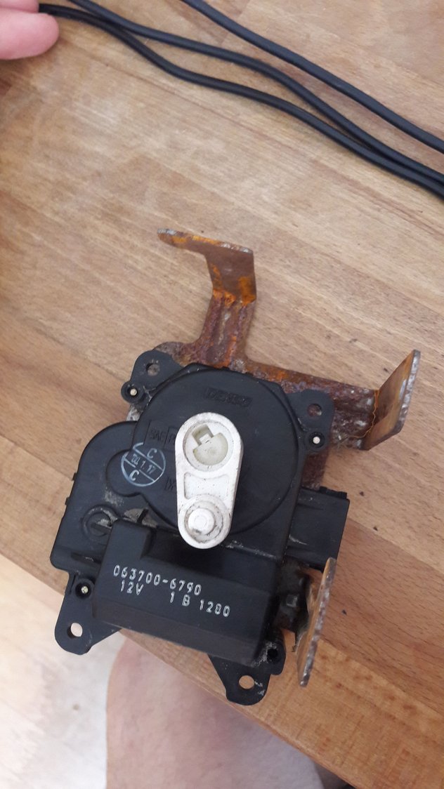

Recently my s2000 took a lot of water damage and im rebuilding it, doing great so far. However i recently stumbled across the 3 broken servomotors for the heating unit. I want to buy them used but i need some help with picking the right one.
On one of the servomotors i took out of the car it has the number: 063700-6790 written on it. So now i need to know which of the numbers should match when im buying the 3 new servomotors? And is this number the same for all 3 of them.

Here's a parts diagram (2005 model). May help:
https://www.hondapartsnow.com/parts-...ater-unit.html

https://www.hondapartsnow.com/parts-...ter-valve.html
#2 is the heater valve assembly.
*Edit here is the part number for the picture.
79140-s2a-a01
Here's someone selling all 3 used.
http://www.ebay.com/itm/00-09-honda-...t/201377670467
