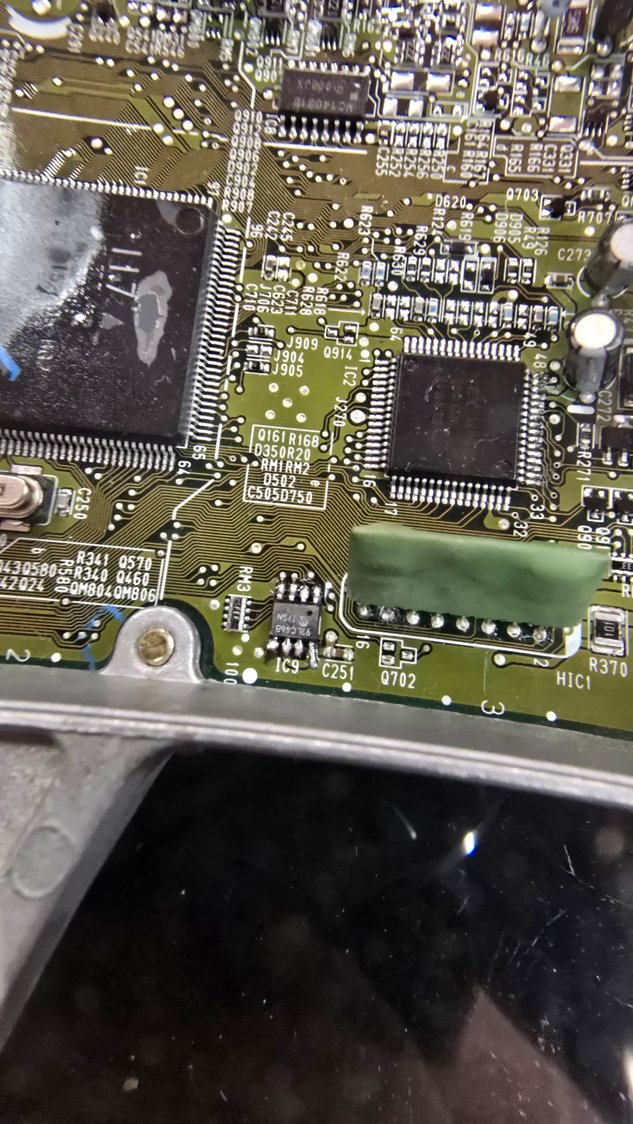

On the board it is labeled IC9 and the chip model is "93LC46B". I am unsure of what the chip does, however I do know that the ecu reads whatever is on it during startup and let's it run normally. So long as its not power cycled, nothing changes.
Very curious as to what insight you or anyone else may have on it.
Is that EEPROM look original to the board? To my blurry eyes the solder joints look more hand soldered than machine. It's a 25¢ chip (probably in quantities of 1000!
Tried resoldering that chip to the board? Might cure some tiny electrical gap. I'm still thinking it's a trace on the board... (Grasping at straws here!)
