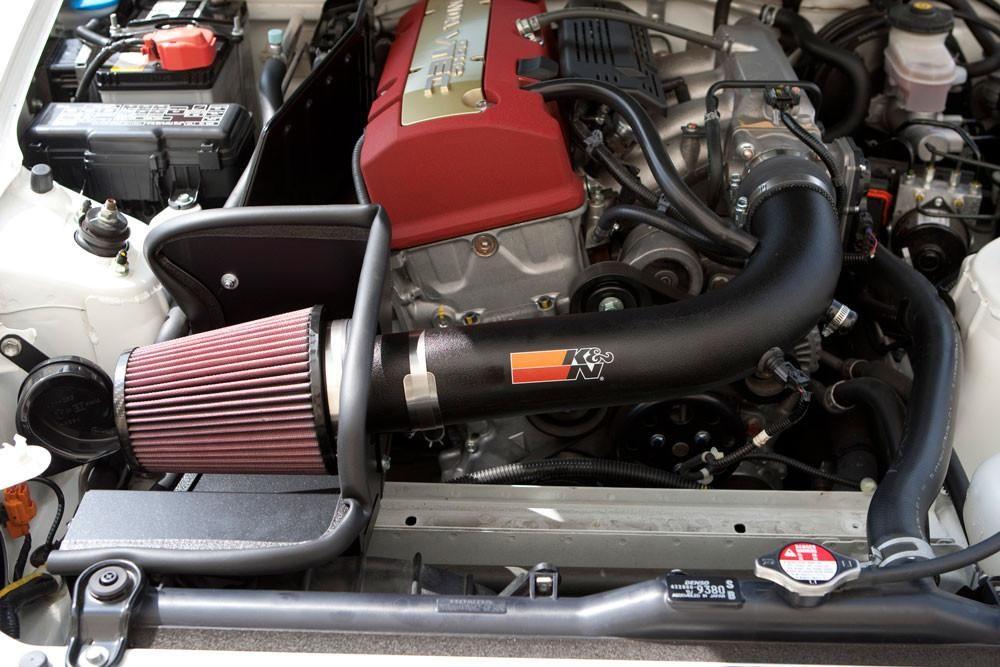

Hello All.
Please help.
I have just installed a K&N Intake System to my 2007/08 AP1 2.0 (UK) When it says to install the check valve and air injection pump to the upper and lower 'Hard Lines' I only have 1 Hardline, so I am not sure whether this would be the upper or lower???. The stock system had 1 hard line & 1 direct connection to the intake manifold.
Can any one help identifying which should go to the hard line, and which to the intake manifold. Must be a European thing?? I will need to extend the hose for the one that goes to the intake manifold.
In the K&N Kit it mentions a Long hose and a short hose but they were supplied the same length which doesn't help.
Urgently waiting your assistance.
Many thanks
Old Nov 24, 2020 | 09:21 AM
Zer0ne's Avatar
Joined: Jun 2006
Posts: 897
Likes: 78
From: LA, California
Your car is a DBW model so there's no air injection. Connect the coolant lines together and the crank vent to the intake arm. Plug the air injection port on the intake arm and attach the temp sensor. It should look like this:
