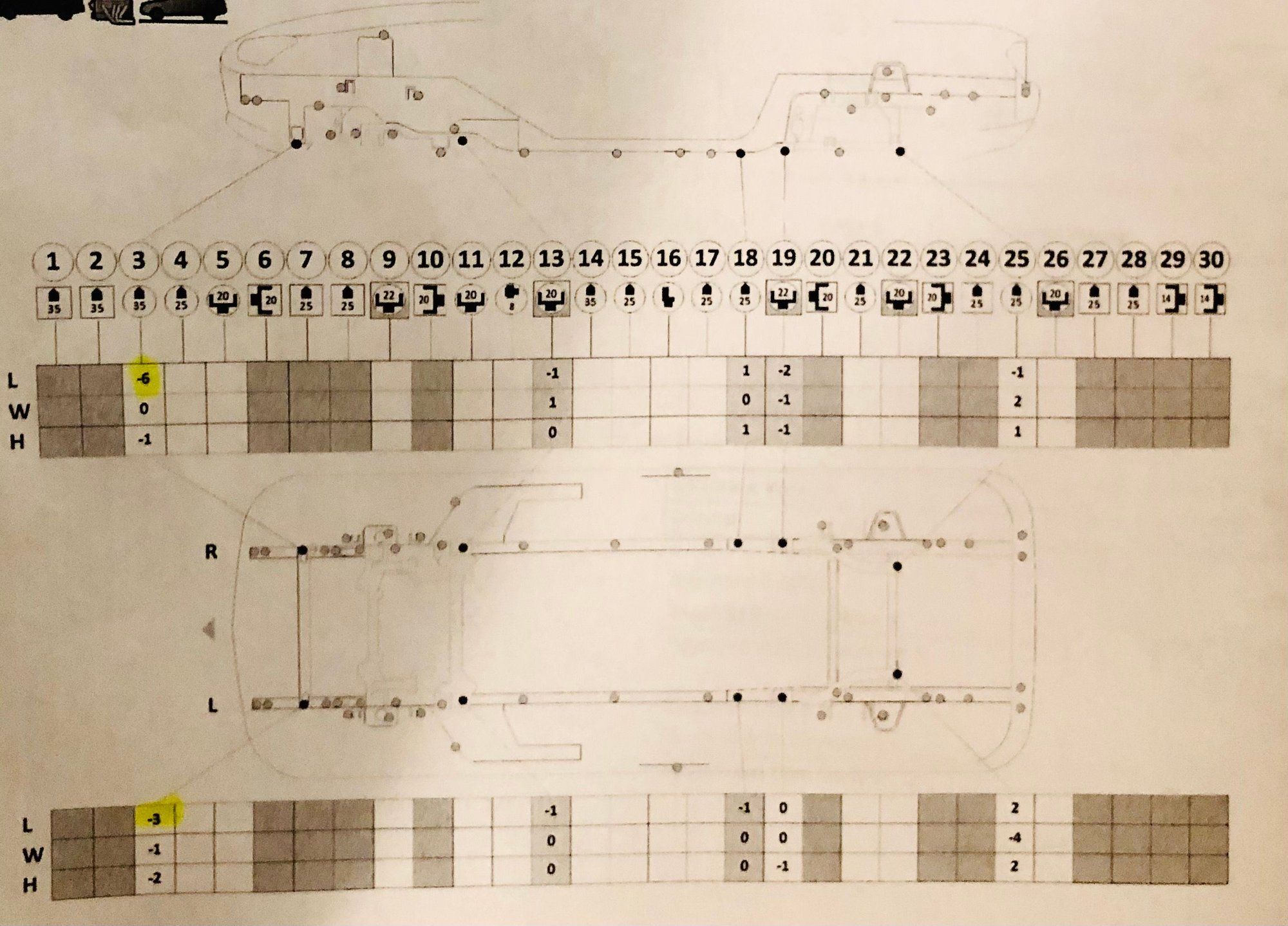

Purchased an AP1 with no carfax damage reported, went thru some potholes in Chicago and got in a minor accident and based on the noise i heard i suspected damage to the frame/subframe. I took it to a well reputed body shop and the results are attached.
Requesting input for the following questions:
  1. Is the overall numbers a concern for an s2000 enthusiast? Everyone will have an opinion to this question but overall, is this -6mm worth keeping the car to do JUST the following mods: JUST suspension, wheels and tires. I want the car to be a bone stock car which can just handle well when i drive it in the Chicago summers.
  2. What should be the average cost of bringing this back into factory specifications if I wanted to?
  3. Is the damage area the sub frame?
Extra info on the car: 2000 AP1, 139k miles with Oil Analysis done and results "great engine", black dots on image shows from where they measured it, to measure the whole thing would mean more $ and work taking out exhaust, engine etc.

They measured at the subframe...which is replaceable and alignable.

Just get this thing looked over for obvious damage. Get the subframes lined up if they need to be. And enjoy it.

Also a program manager/sys engineer here and would not worry about it if the car aligns properly A friend of mine (also a fellow project manager as coincidence would have it) ran his into a wall at the track. Figured it was toast and stripped it down for usable parts since he bought another S2k. Measured the frame and it was closer to 1/2" out of square. Body guy said "is that all???" and they proceeded to build it back into a track car lol.
Like I said, if it aligns properly I would not worry much about it.

Its not unlikely that the subframe shifted slightly.
Its as easy as loosening the bolts and re-aligning the holes. OR buy a set of spoon subframe collars to align everything permanently.

Update when I e-mailed the body shop to confirm if it was the subframe :
"the measurement point in the front of the vehicle are at the bottom of the radiator support, which is commonly referred to as the lower tie bar. That is a different component from the sub frame or suspension crossmember you are referring to."
