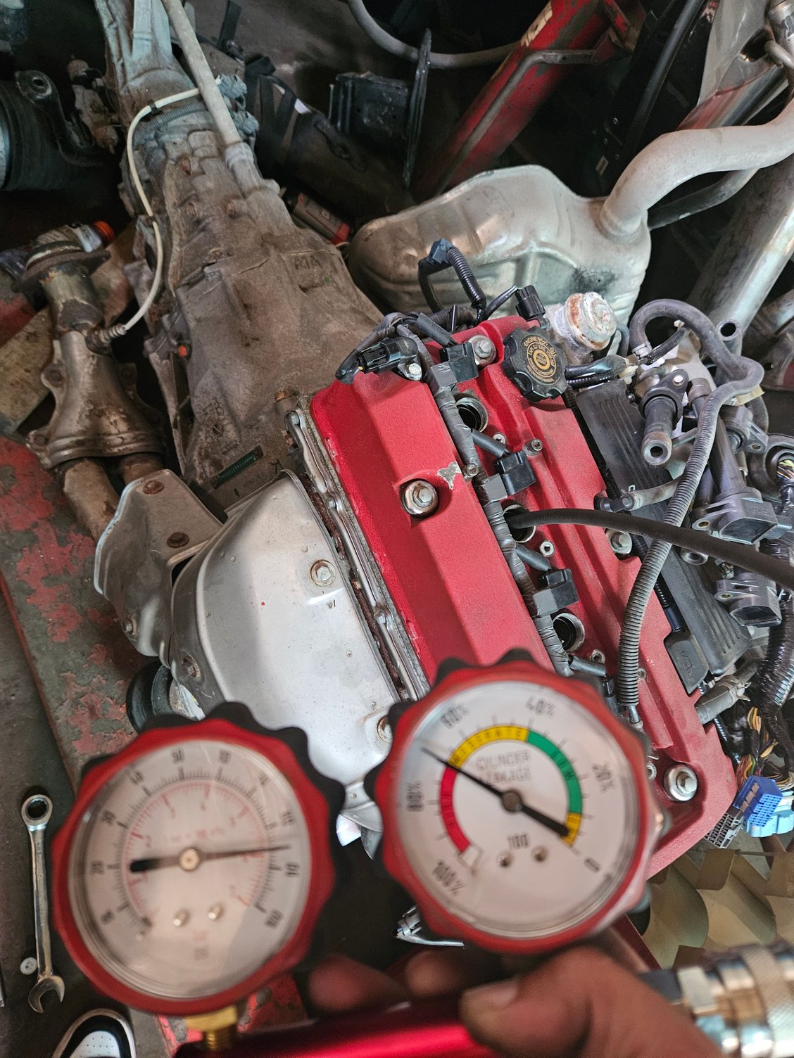

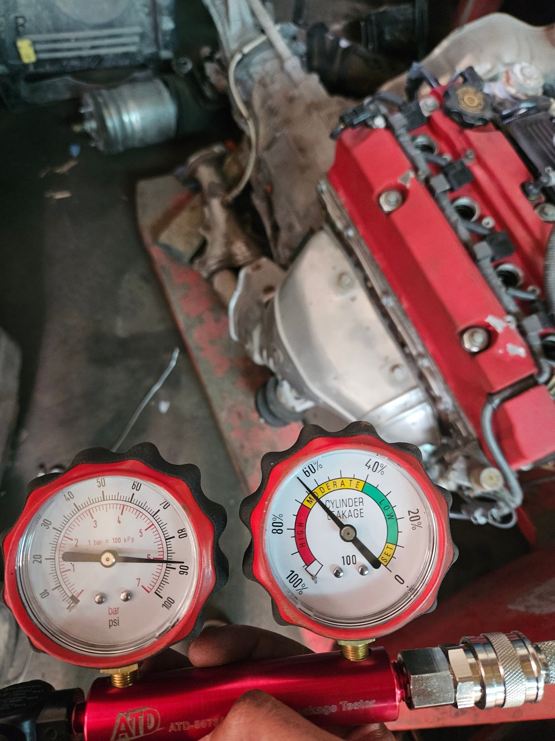

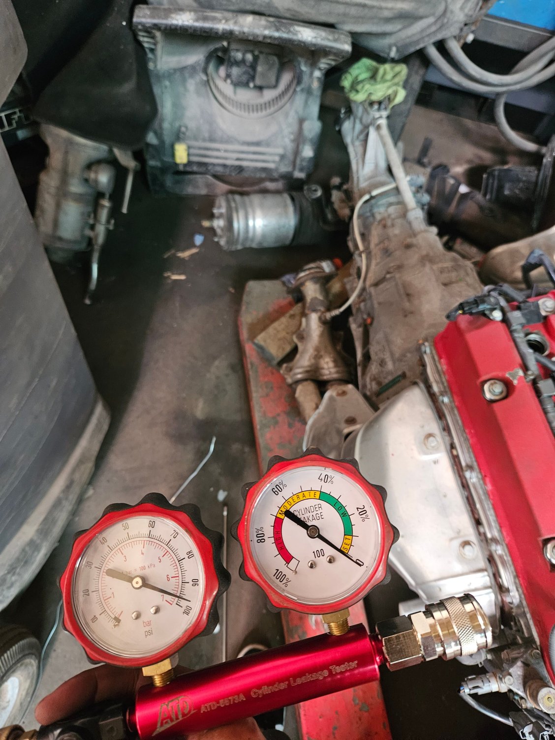

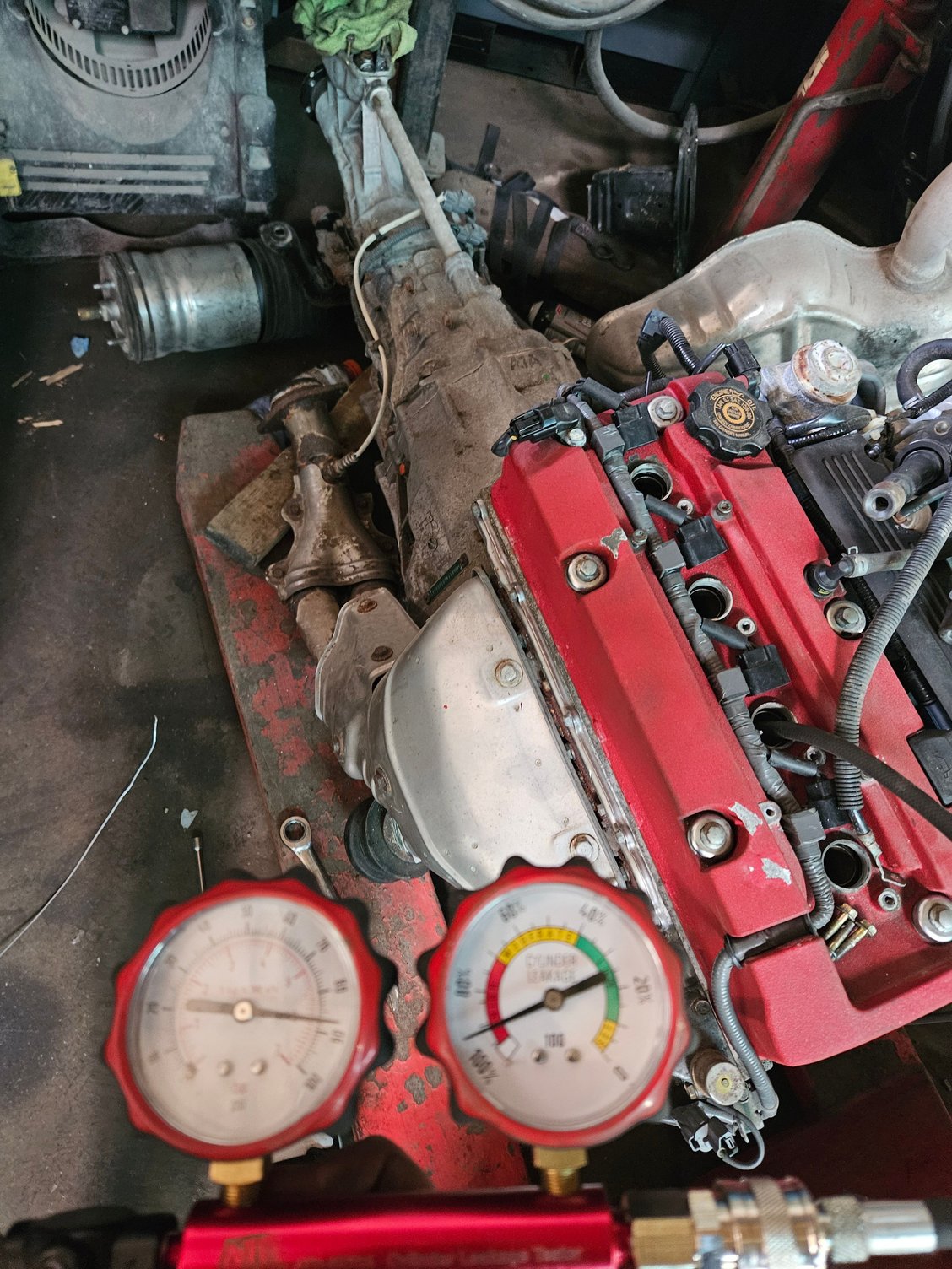

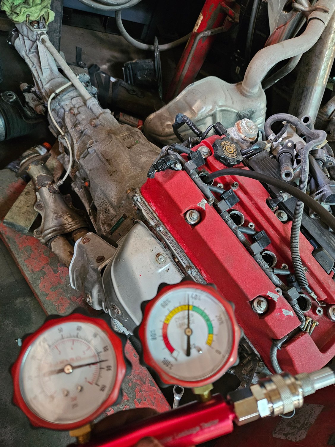

I think the chain might have gotten damaged by salt water causing the timing to jump. Coming from the exhaust
