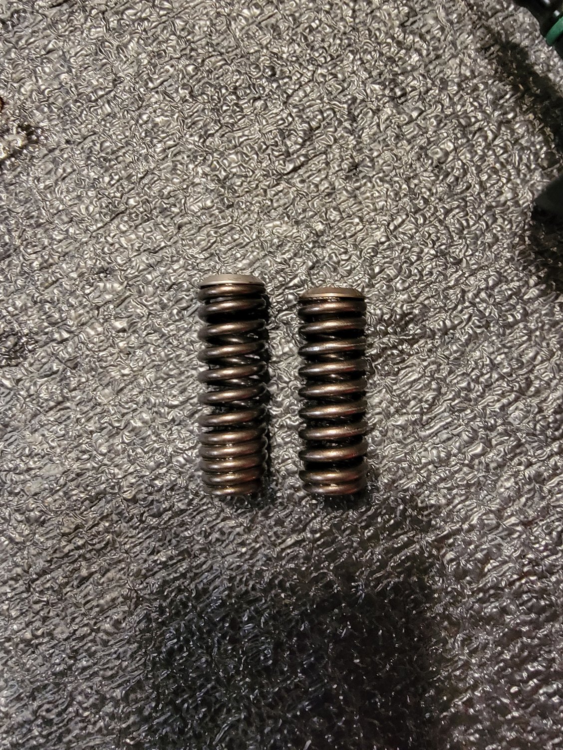

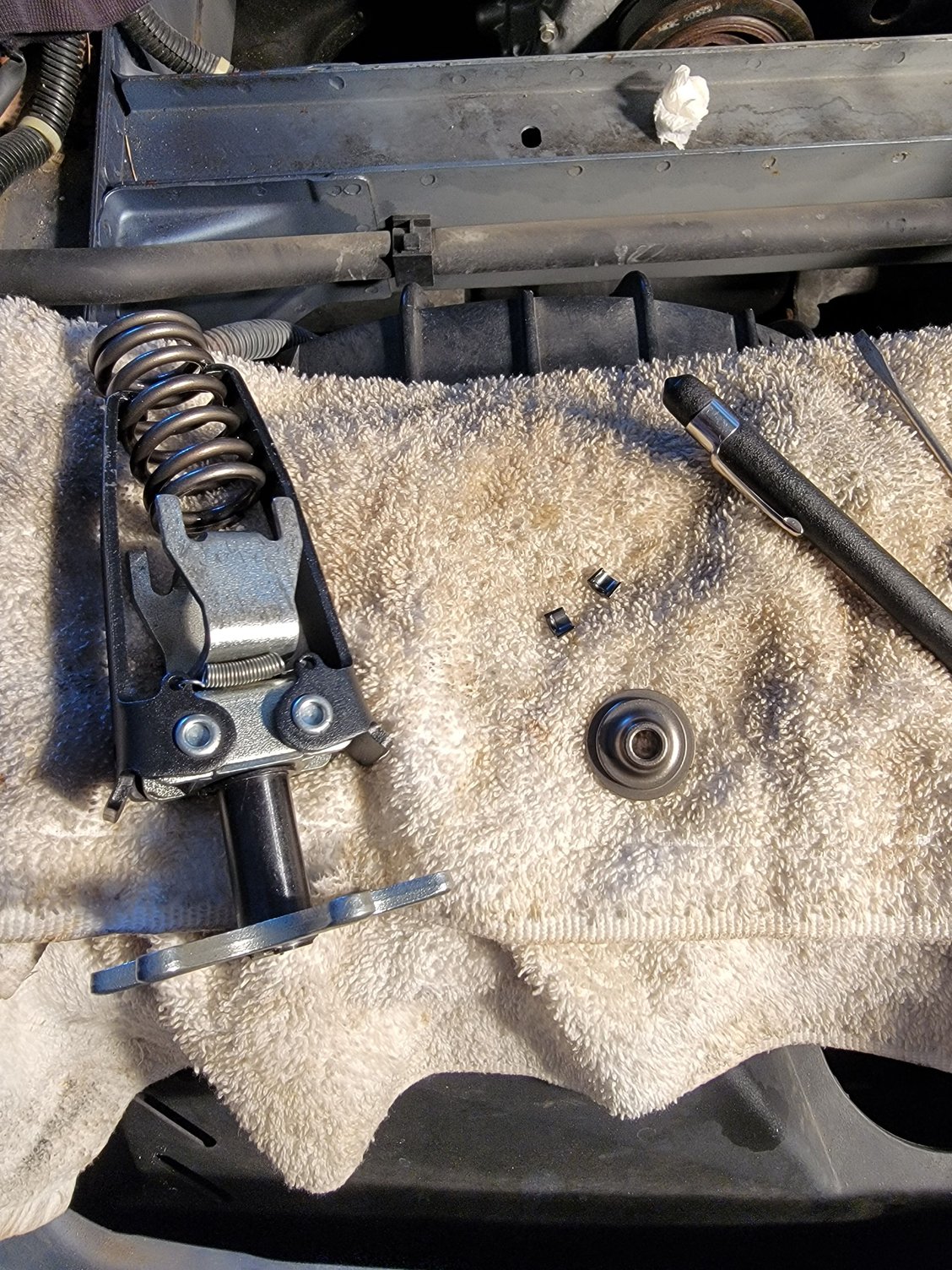

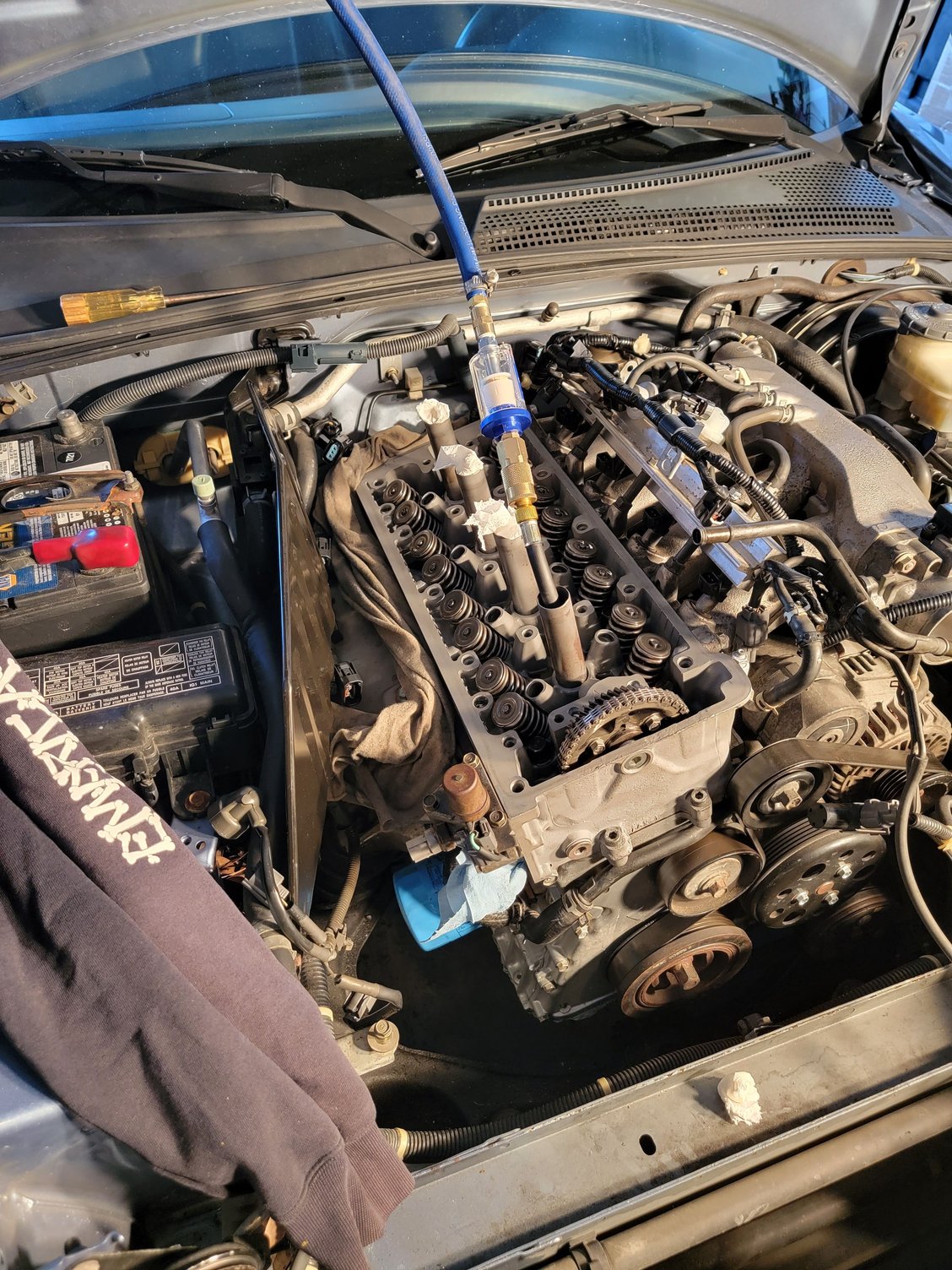

So little update i replaces the lost motion assembly on the intake side so all are the same size. I replaced all the retainers and keepers to ap2 style so I never have to worry about that again. Few pictures attached. I just have to adjust the valves and put the valve cover back on and i will see if it solved the problem....
Did some with compressed air and then some with nylon rope
Cheap parts store tool worked fine
Layed out all old ap1 junk
