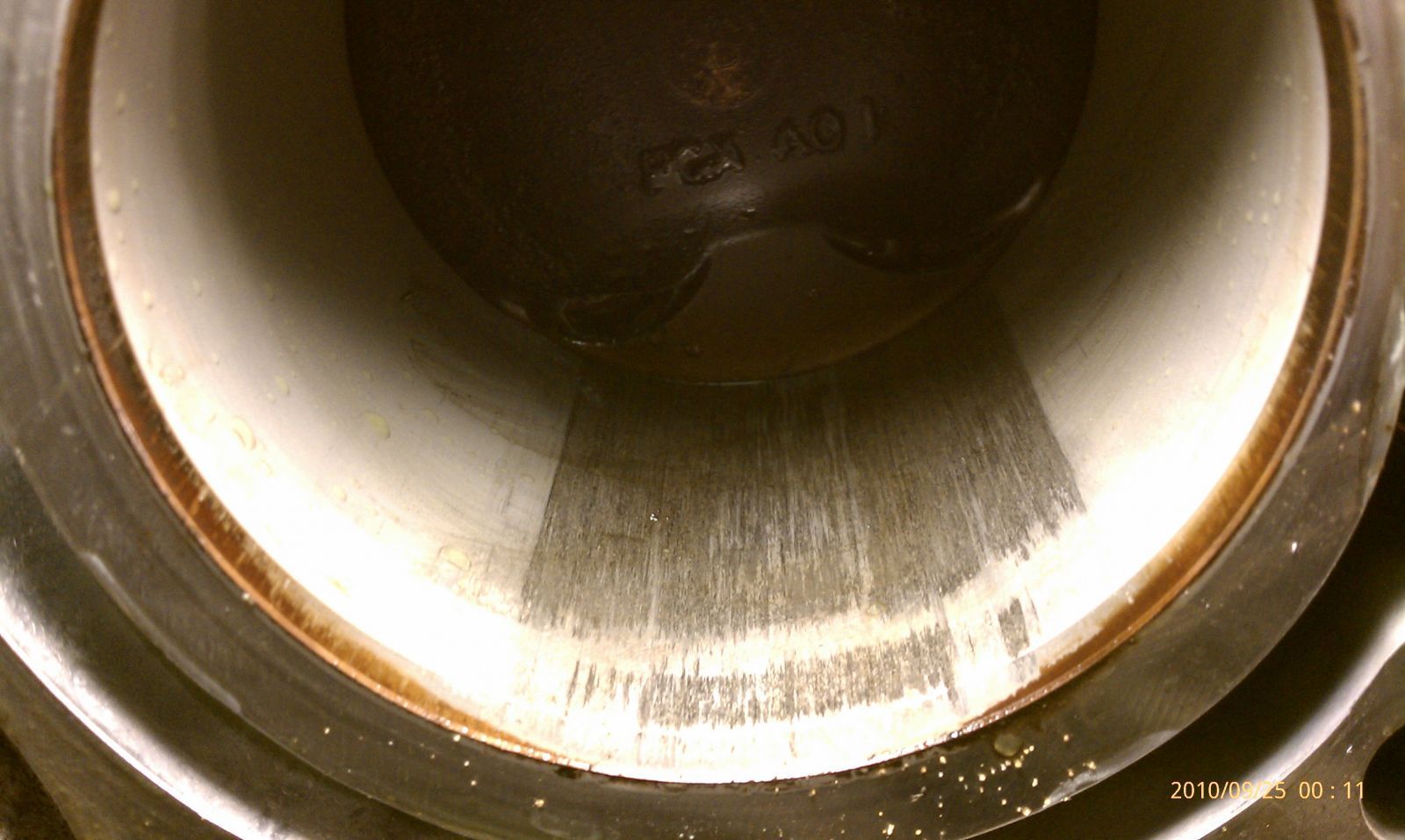

Loud engine clacking/tapping noise - Cyl #4
Black streaks.... yes.

Originally Posted by Billman250,Sep 13 2010, 04:39 AM
Streaks are as wide as the piston skirt, and appear black yes?
Noises can be hard over the internet sometimes, but high compression in #4 was a dead giveaway.
did you do any high spped runs? was the car ever supercharged or turbo?

Cylinder scoring is not due to low oil. It happens from high piston temps or lubrication, likely due to the old style oil jet bolts.
With low oil, the rod bearings will be the first to go.
4DCurvs, I can't here anything definitive in your vids. I would be very surprised to see a scored cyl in your car, as it's a 2004.
