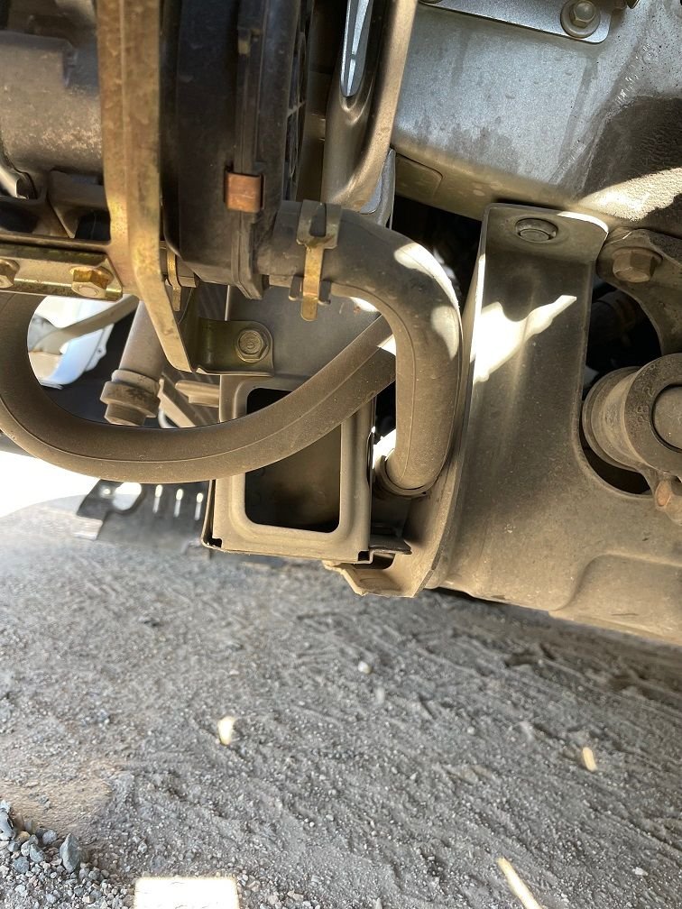

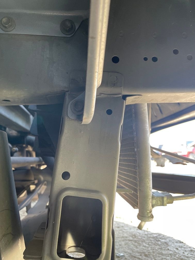

Hello all. Newbie here. I am in the market for an S2000. I am really close on a purchase of one in which an old lady seems to have hit a bit ass rock. Is this something I can fix? I cant seem to find a part number for this. I came across an older thread: https://www.s2ki.com/forums/s2000-un...1101131/page2/
The persons in the above example seem to have really twisted that piece. Any advice would be appreciated. Thanks! Hopefully introductions will be proper if I end up picking this one up. Thanks all in advance for the assist

You can put a long prybar through the bottom hole, and straighten it right out. I have done it countless times.
