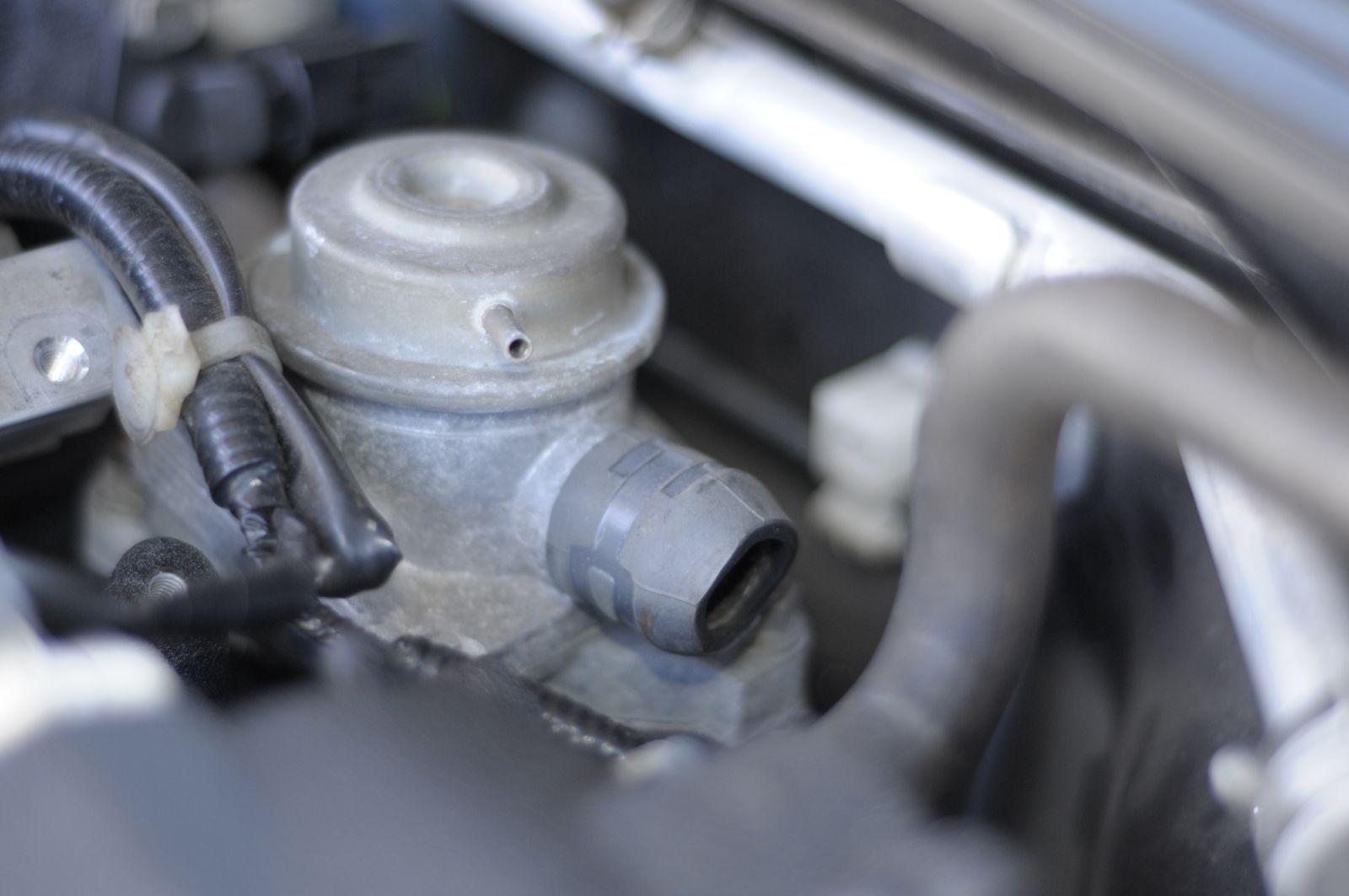

this is not blocked off, but I think it was done like this on purpose
im so ****** mad
im so ****** mad
Yea that can be opened, thats the air pump valve, thats not the issue, check for vac leaks, check the o rings around the injectors too.
