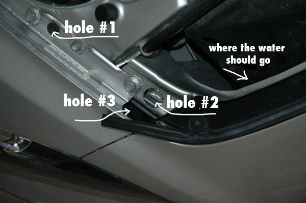

i checked the the rain gutters under the hood. this is what i found:
I plugged both holes #1 and #2 as advised upon installing the intake. After some time i figured out that this doesn't help. in fact, i discovered that in the 04+ it makes things dramatically worse. you see when you plug the second hole water will go towards the headlight, hole # 3. this is the hole that leads directly over the intake itself, thus soaking the filter. So if you plug holes #1 and #2 you are sending water where you don't want it to go. a big mistake. you need to plug all three holes to be effective. i imagine that this must only be for MY 04+.

But after i plugged all three holes, no water drips from the gutters into the intake. you just have to plug all three, that was my problem. i can feel the filter (i cut out the black section of my bumper) and if it get's wet during the next rain, i'll put an umbrella in.

Did you take the filter off and check the elbo down there? I'd be willing to bet you've got some water laying in there.

sorta, i'll be working on the car today so i'll do a more thorough check. i know there was water in there, whether or not water is in there now, i don't know.
but yep, that would cause the burp.
