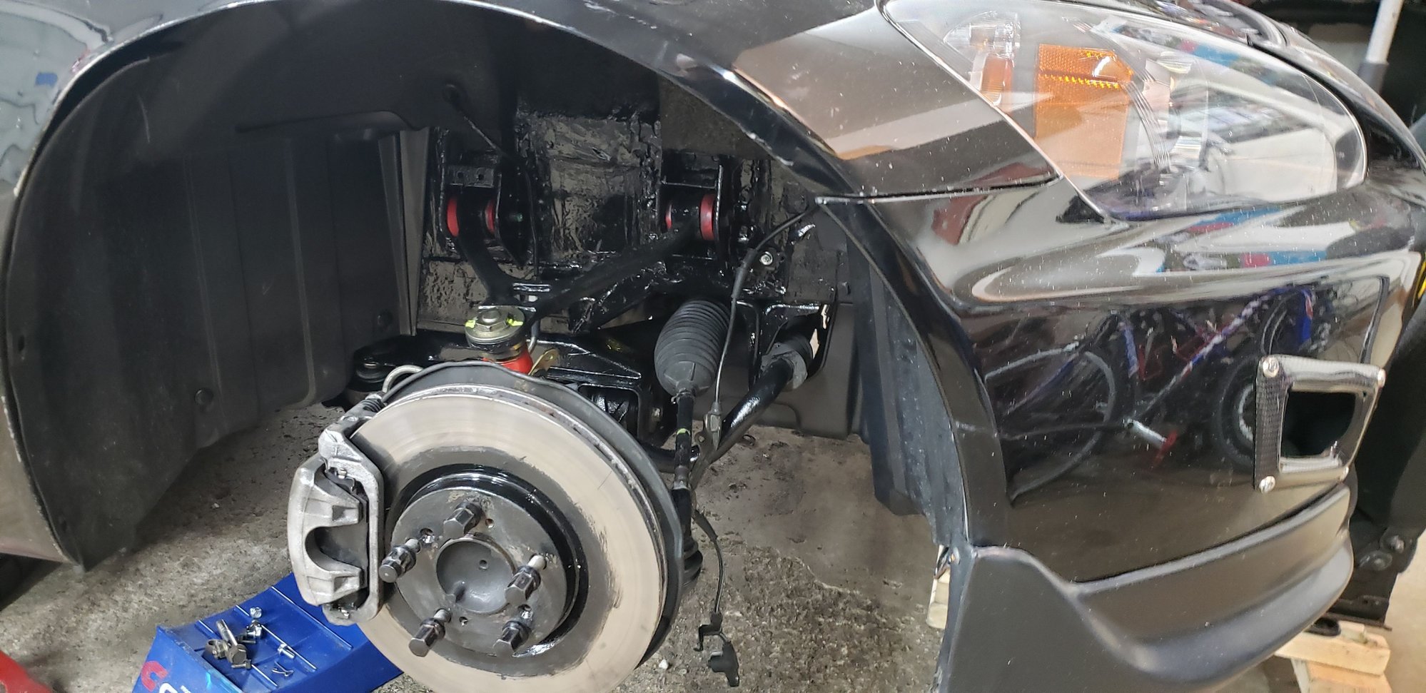

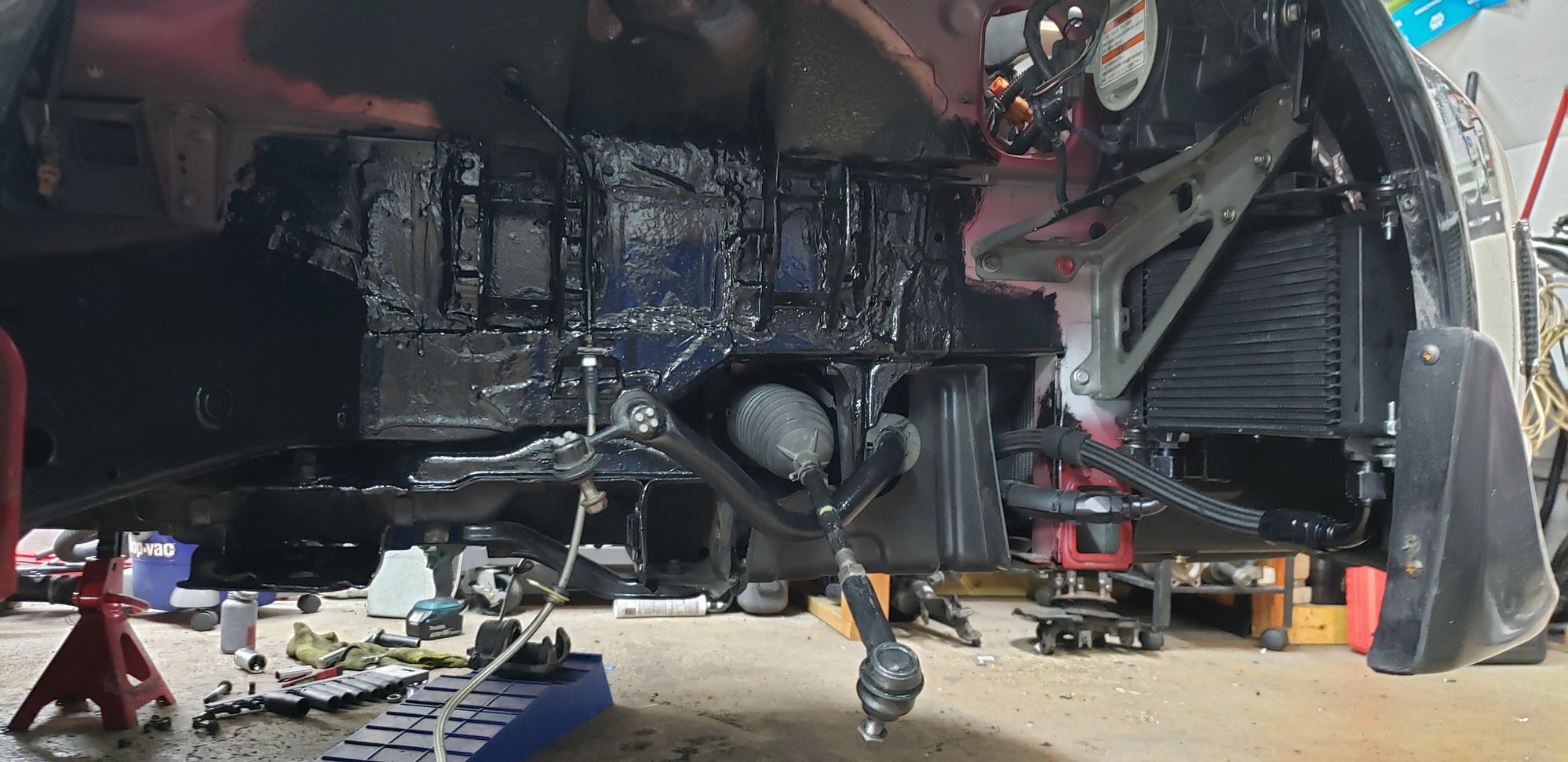

Before you start stripping the coat.....you need to unclip, unscrew, and move the brake line out of its holster. REMOVE the ABS wire completely.
I stripped it with an angle grinder and cone shape coarse wire brush head (don't use a flapper).
wear a mask or respirator.
I MIG welded it myself.
I coated the hell out of it with POR15 epoxy.
I then used automotive seam sealer to seal all the welds/gaps.
Then top coated it with black (urethane?) brush on chassis paint.
I'll try to find the "during" photos.....but here is the end result...
Obviously, I would never drive the car in snow or salt after doing this. All the coating that was burned off inside the frame rail is impossible to re-coat by traditional means.
And....definitely keep a fire extinguisher handy

oh, boy, its been 9 or 10 years now...I removed the upper A arm, bolts, damper/spring. I can't recall what I did with the brake line, but I think the welder was able to isolate it and the heat wasn't an issue. The photo by B serious about sums it up, although I didn't remove the lower A arm/knuckle. I also welded both the the inner and outer portion of the mount.
good luck!
darcy
