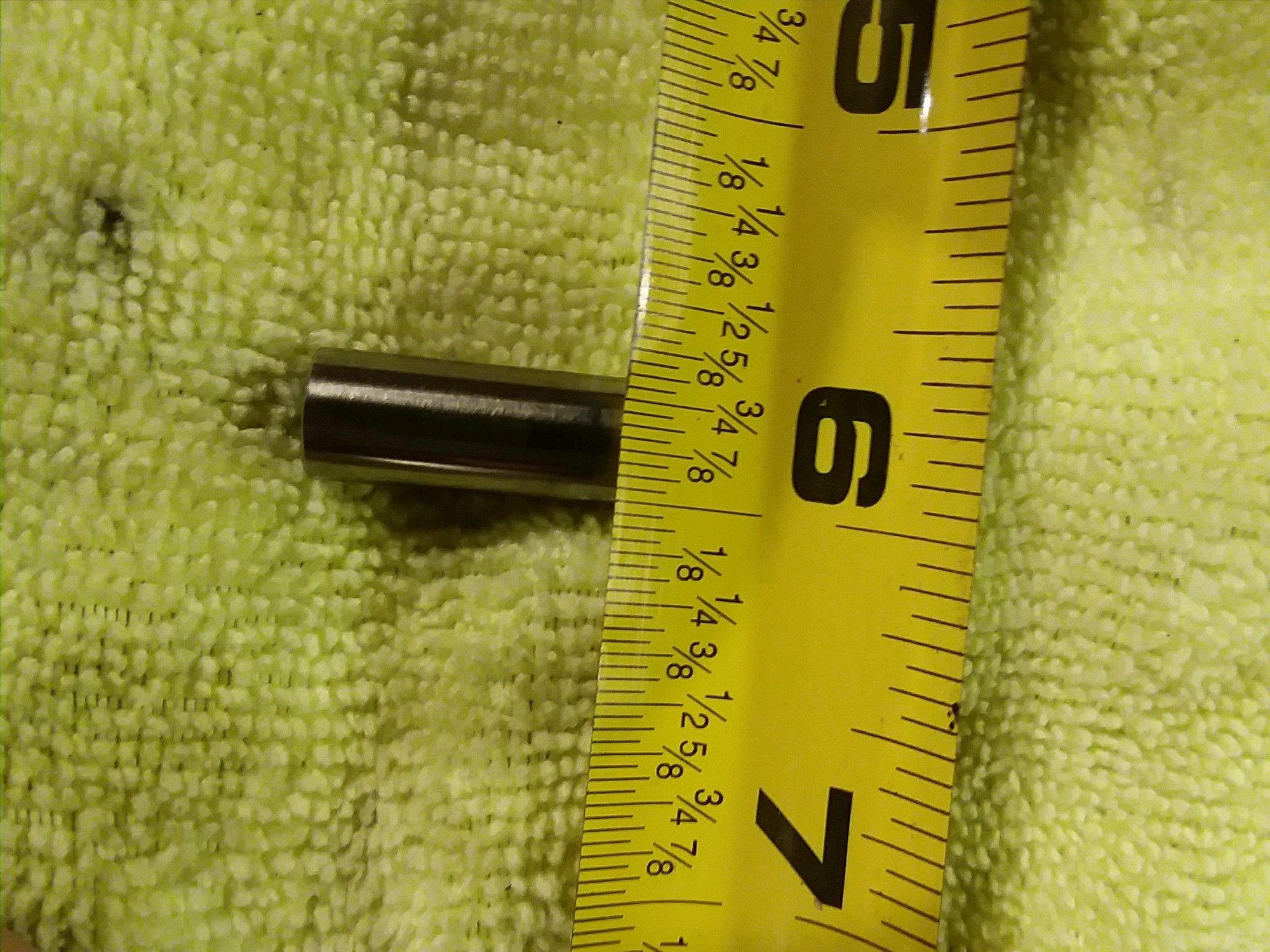

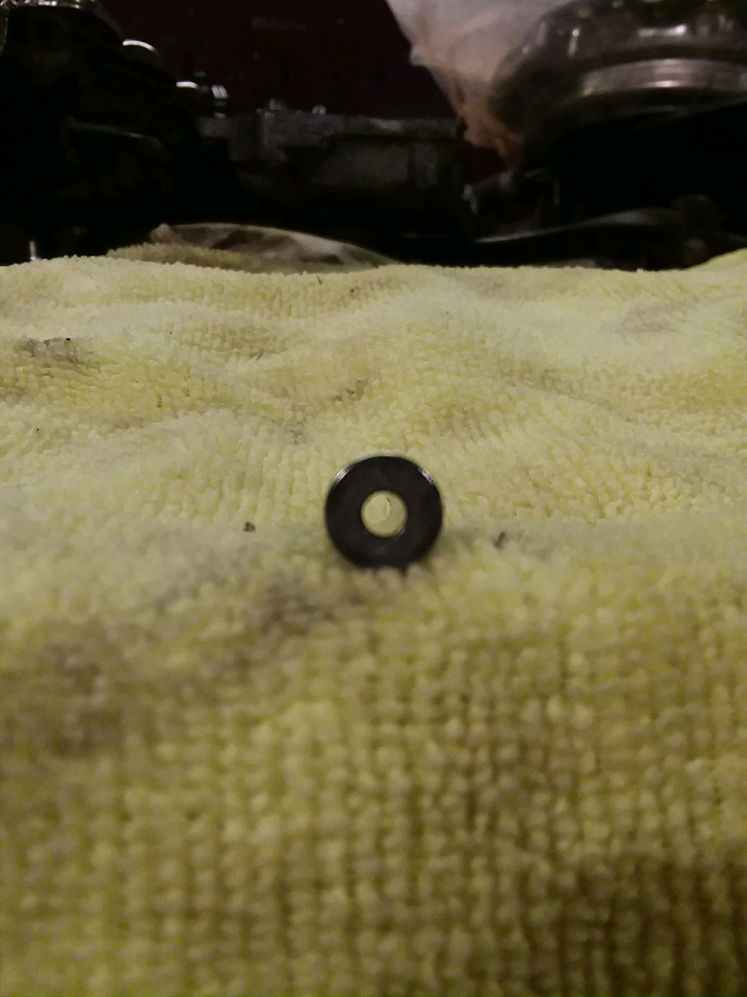

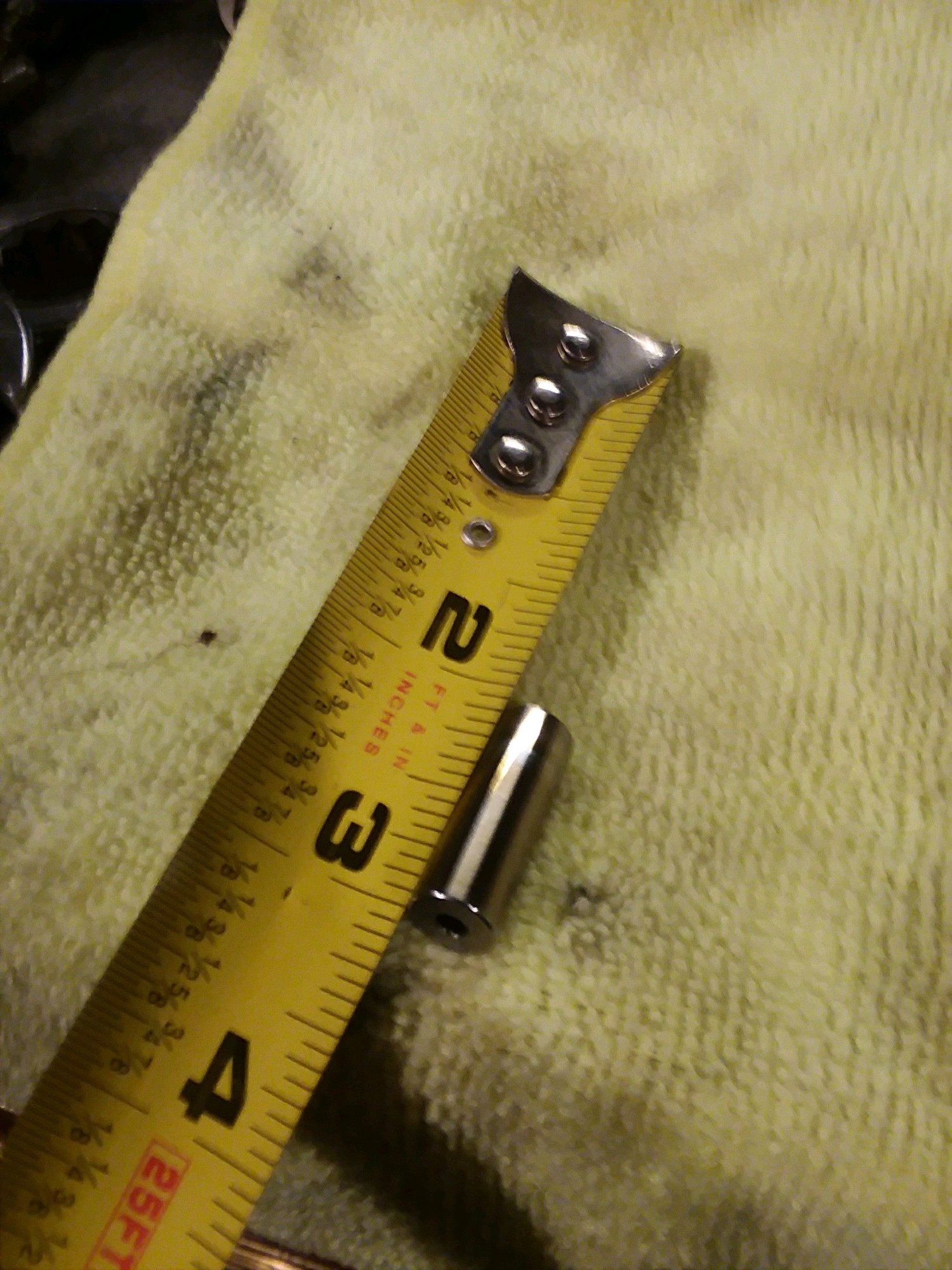

I am rebuilding an f20c engine and this small part fell out from somewhere? I am going to try to attach a pic- I think it was from the head or timing chain area. I was hoping someone knows this? I was also curious about my rebuild. I am getting the block sleeved and JE pistions and skunk 2 rods- which all is crazy expensive to get done- well over 3 grand for the block alone. Do you guys think that will be a good selling feature for someone looking for an s2k? Mine is a 2000 grey- with 85 k miles? Any input would be welcome. thanks guys!

https://robrobinette.com/S2000ValveAdjust.htm
Dowel pin?

thanks! I think that is not a dowel pin- they are thinner walled.

that is one of the dowel pins that go in the rollers.
can see it here in the 3rd photo https://www.s2ki.com/forums/s2000-un...sembly-654328/

Yep VTEC pin in the rocker arm for sure.
