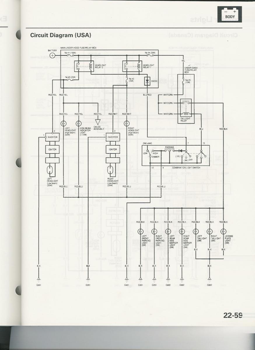

Hope you appreciate this I had to break out the old scanner sitting in the back of a closet and boot up my old Win98 machine. It doesn't seem to correspond to the wires you have listed though, at least not all of it. Click for full size.

Dan, Thanks alot!!!! It looks like I'm missing the taillight relay...hence the mystery socket. No wonder the rear turnsignals don't work. Im gonna try to work on this mess now. I hate electrical work!!! Sorry you had to go through all that for the scan. Afterthought.. I could have met up with you and made a copy of the diagram. I should be able to decipher this with the diagram and my tester. I might be rollin by next week.
Anyway thanks again,
Manny
