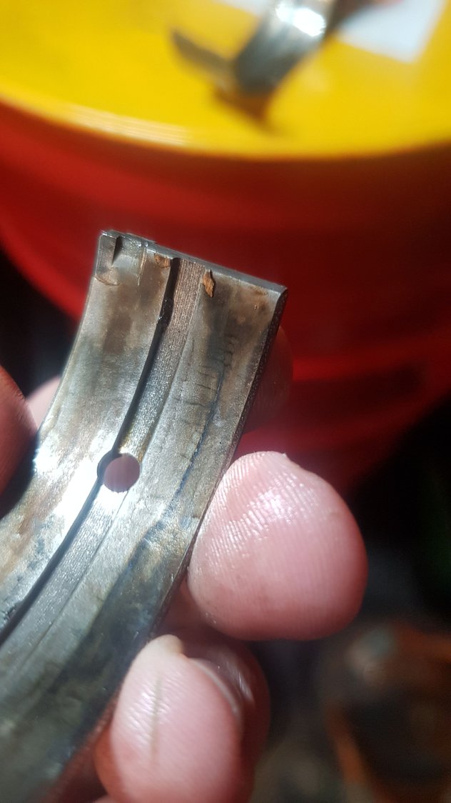

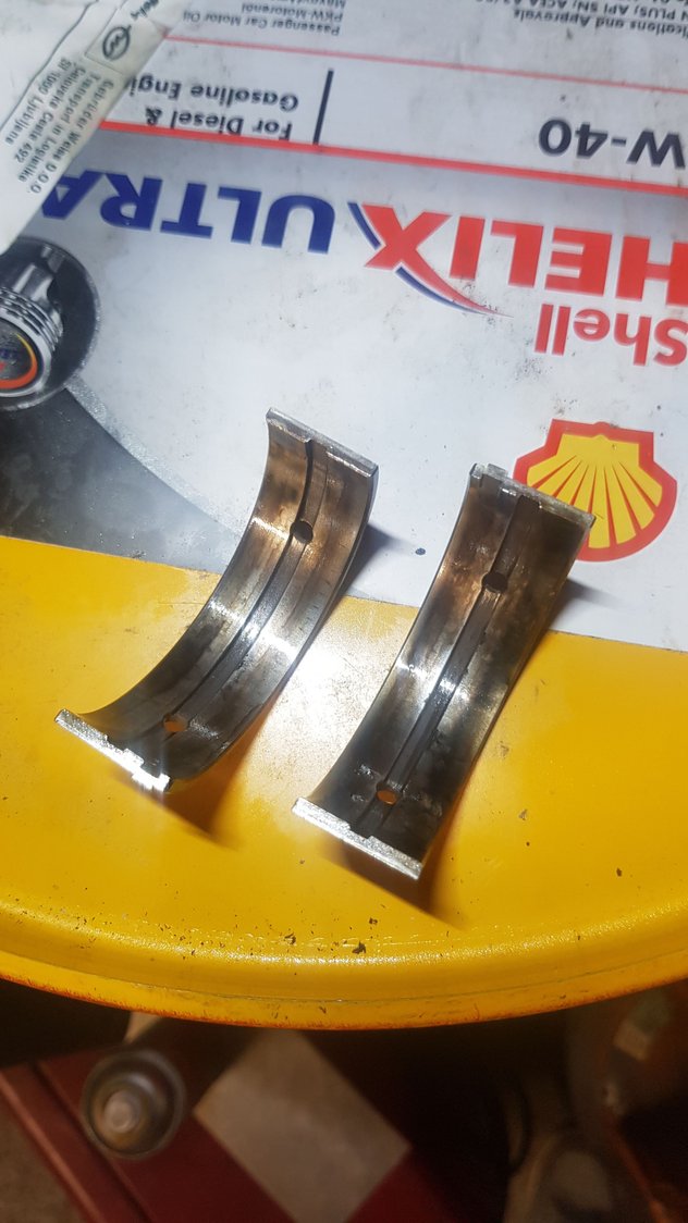

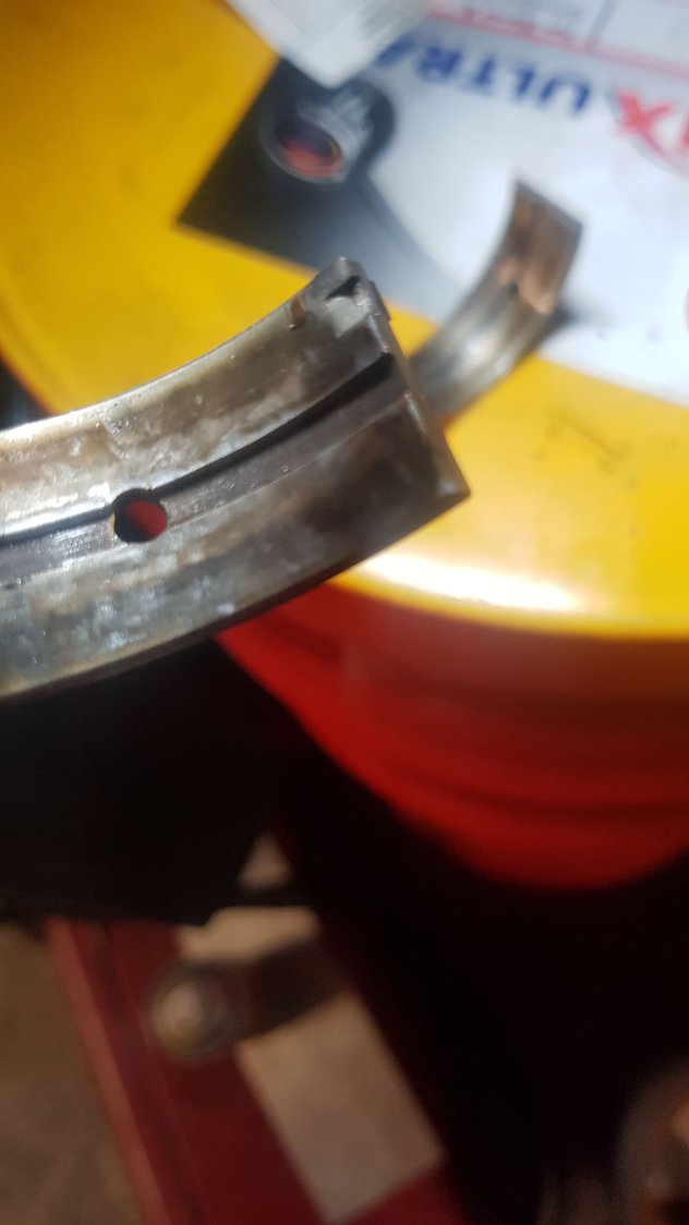

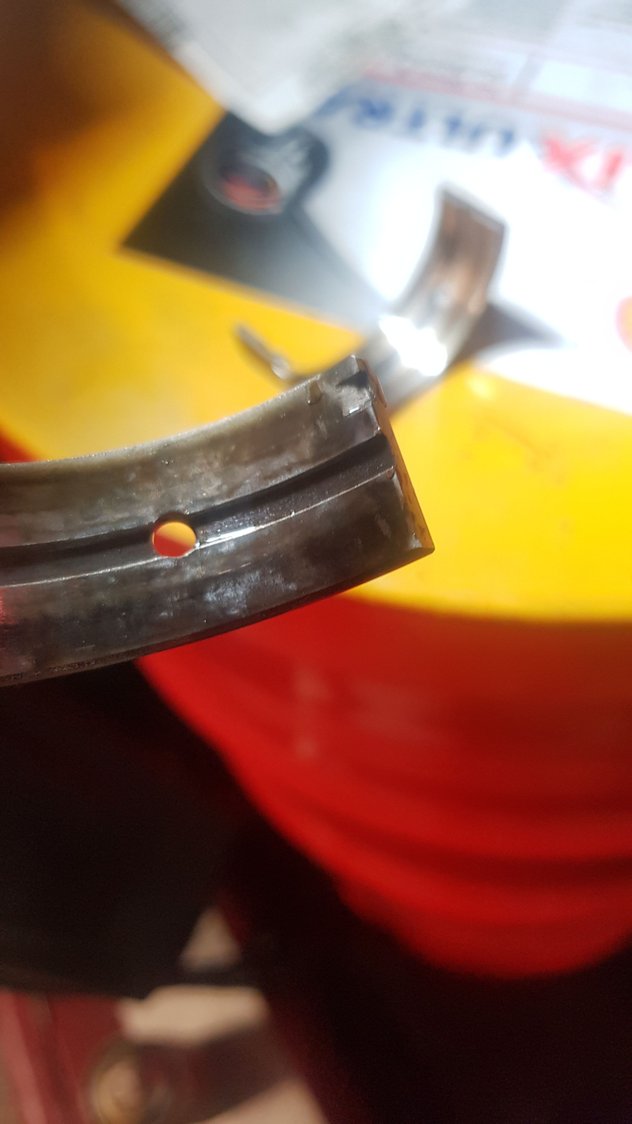

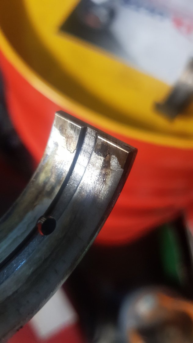

So the engine is finally disassembled. Oil analysis showed the oil is within the specs....now the interesting part is that 2 of the main bearings in the middle are gone....all material pealed off....only a spec of brass is present...all other bearings including rod bearings are completely intact. The material looks like it flew off in just a couple of seconds. This show its the same problem as before with last new engine. The only difference is i shut of the engine immediately this time so no other bearings got hurt.
Soo......what now

well, this is starting to look more like a manufacturing defect.
if Honda doesn't acknowledge this evidence, perhaps you have enough evidence to pursue a legal case?
