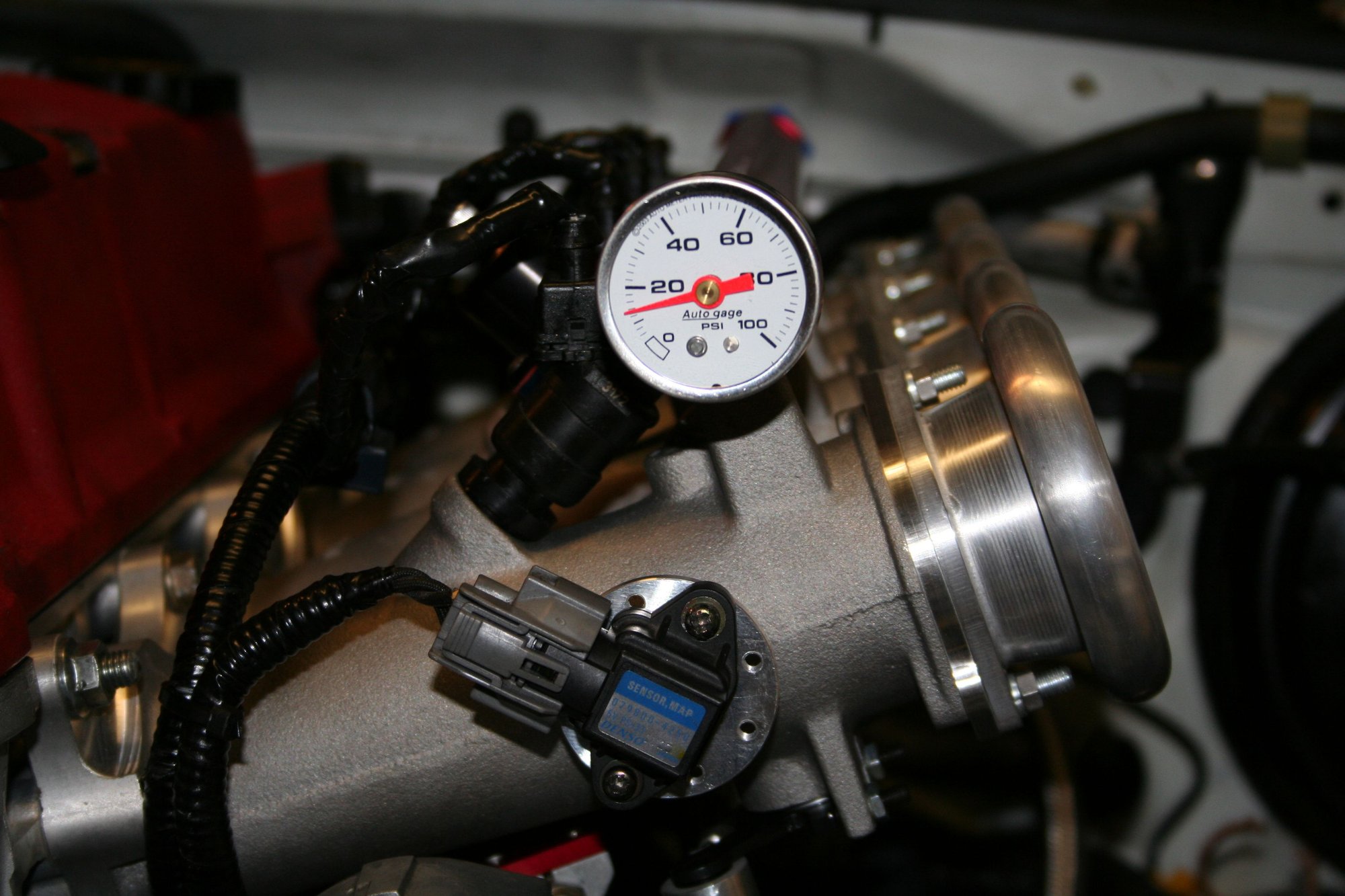

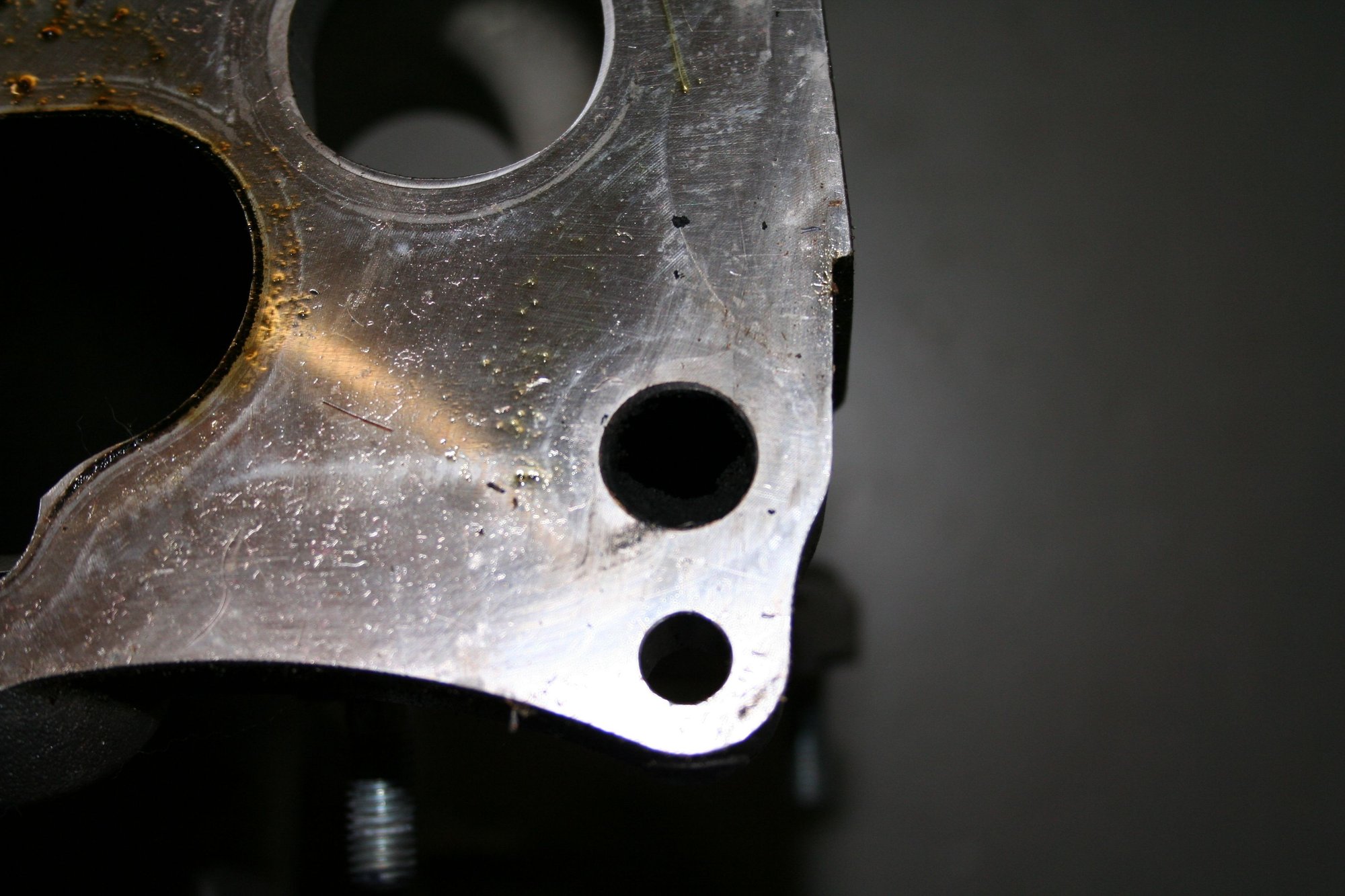

also, even itb with a vacume accumulator the map values will be completely different then sotck, and the speed density must be turned off with in the stock ecu (impossible). the other thing is with the methanol injection the way you desibed it will more then likely leed to lots of fireballs in your engine bay, say the stock ecu would run the itb, i highly doubt youll be able to get the methanol injectors to be timed properly, there is going to be some delay be it micro seconds it count when you get to this pointif form nothing else the way want to wire it will more then likely cause a delay. Also about the camgears being more helpfull then camshafts is true to a point but wiht this motor unless you have aftermarket pistons their isn't enough valve relief to make the sprokets usefull. and there is EGR but, your right about itb kits getting rid of them.
here is the egr port
p.s im almost done
notice the maps sensor accumulator cast into the manifold, eliminating the need for a bunch of vaume hose and an external tank.

White_S2000@16 who made your ITB?
Interesting to have the map cast directly on to the manifold.
One question this MAP only gets a pressure reading from only one of the TB's????
So are you assuming that each ITB is performing under the same vacuum as TB#1 for tuning purposes?
