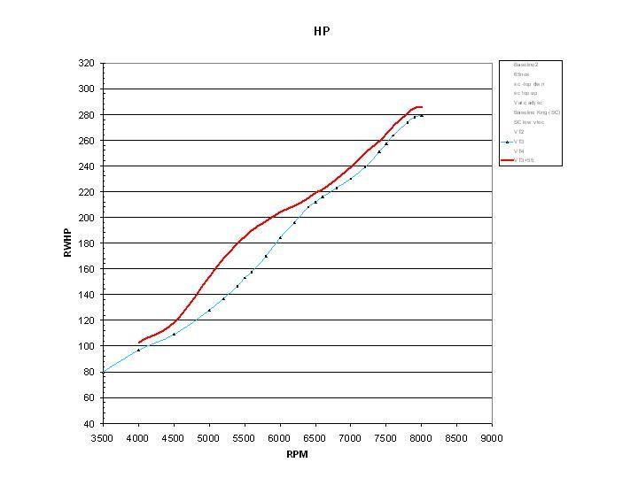

You definitely need to be careful and smart about it. I run 55 shot only rarely and when I do, I have a boost activated shut off switch. I also run pretty high octane fuel.
My nitrous shuts down when I get to around 3-4 psi of boost --approximately around 6.5K RPM.
My HP vs RPM curve looks like a turbo charged S2000. About 40 more HP from 3.5K - 6.5K due to Nitrous. When SC boost starts to kick in, my nitrous shuts down. Peaks around 300 RWHP but that's non-nitrous assist -- only vortech.
Doesn't increase my peak HP, but increases my mid range power, and thus overall acceleration. My guess is upper 12's at about 110+ MPH for 1/4. Need to take it to the track soon. I can trap 107+ MPH without Nitrous and a soft launch.
The other benefit is that I don't waste too much nitrous since it is activated for only a brief amount of time. Also based on my testing, Nitrous doesn't improve much after VTEC.
Here's a plot of my data based on PDA Dyno. There's a bug with the software in that it does not compute HP from 8000-9000 RPM, but you get the idea for a comparison. With this plot, I turned off nitrous at about 6.5K RPM. VTEC engagement was set to 5300 RPM. Red line is Nitrous assisted with SC. Blue line is SC only.
