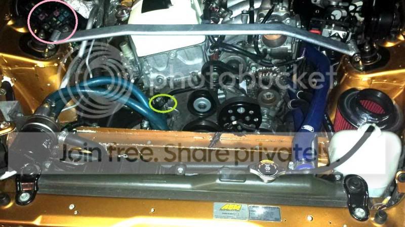

I have no AC in my S and i'm pretty sure it's because it's not hooked up as you can clearly see in the pictures..
I'm wanting to buy all the parts I need in order to completely restore a stock Ac/Heater system and i'm not sure what all I need. I'm pretty sure the owner before me had removed half of the system in order to install a turbo in the car. I'm not entirely wanting to relocate my fuel filter back to where it was unless it would be better for the car. I think it's kinda retarded of why they moved the fuel filter in that location.

does your car run?

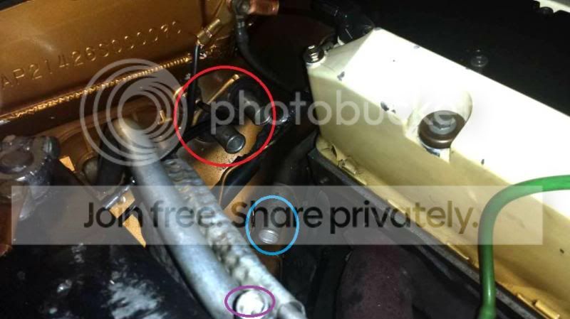

Second pic is showing some oil system stuff

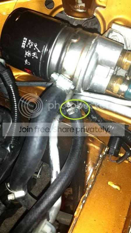

The 3rd pic is pointing to coolant lines for the heater
I can see the AC lines in the pictures (hard aluminum on passenger side, and two rubber lines on drivers under the radiator hose)

The second pic shows what looks like to be a hose that replaced your low pressure line from the firewall that runs along the crossmember to the drivers side of the car.

Originally Posted by MandaJane
From this picture, it looks like you still have your A/C lines but the heater lines are gone.

I agree with the previous posters; you have AC, but not heat. Additionally, that is a relocated oil filter/cooler (not fuel filter).

It seems you have most of the A/C lines in there. If I were you, I would meet up with somebody local who has the full A/C systme in their S and compare it to yours. You will quickly find out what you are missing and what needs to be replaced. Good luck!

Too many posts to quote >.< Yes idk why i keep calling i fuel filter idk where I even got fuel from when I know exactly what it is lol. And yes I was told I do have AC but i can't feel it, i'm guessing because i'm getting engine heat cause the 2 ports in the firewall are open. I was told to just buy some hoses and plug it in from the ports to where I have my oil filter relocated.

It is very possible that your system is not pressurized or it does not have any freon in it. Try taking it to a shop to see if they can "re-charge" it
