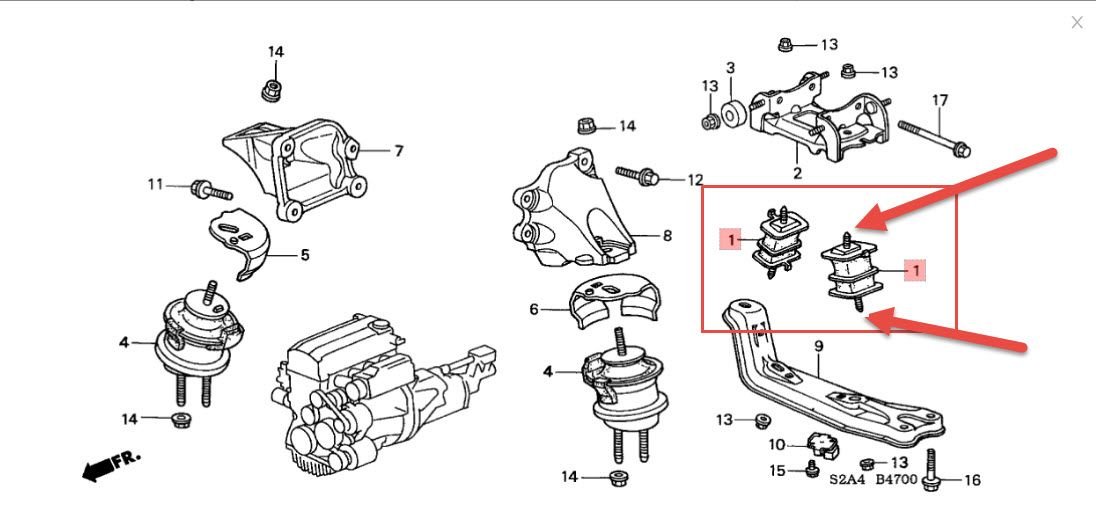

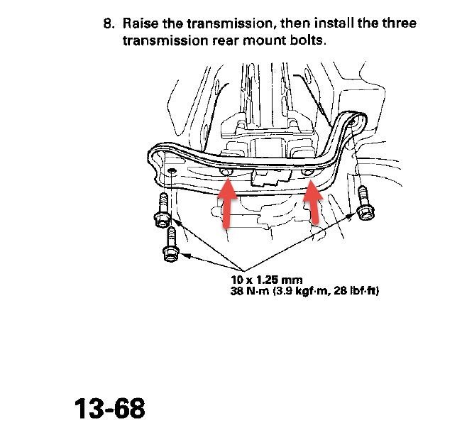

Hey everyone, I'm about to replace my transmission mount with brand-new OEM ones, but I couldn't find the correct torque spec in the service manual.
  • Part Number: 50806-S2A-000
The three 14mm bolts securing the transmission mount to the frame should be torqued to 28 ft/lb. However, I couldn't find any torque specifications for the single 12mm bolts at the top and bottom (indicated by the red arrows in the diagram) anywhere in the manual.
Does anyone have any insight on this torque spec? I'm considering tightening them to 28 ft/lb, the same as the transmission mount to frame specification.

Should be about 16LB-FT.
