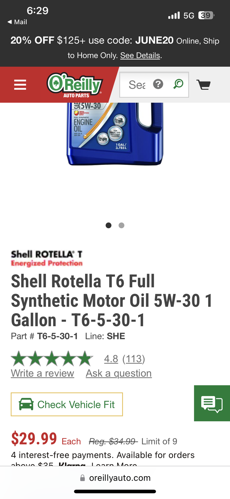

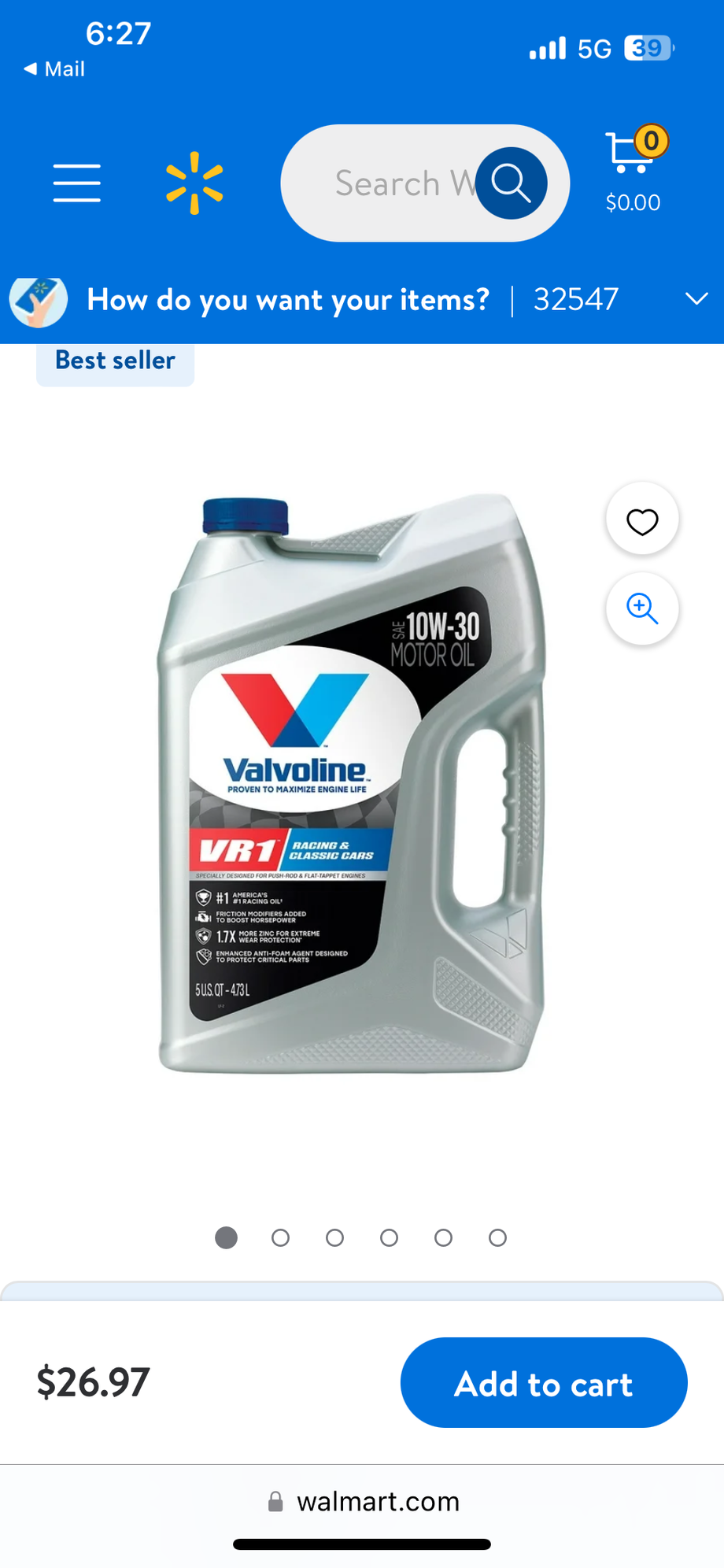

quick search for oils with high Moly came up with these 3
Rotella T6. I used to use the T3 in my 74’ Land Rover and my 85 Merc 300SD
I’ve used plenty of Mobil 1 in the past
Not really used much valvoline but this was the first result when I searched.

I have been impressed with the new Valvoline synthetic oil formulation, they improved the additive package a lot and it is a full synthetic. It is easy to find over the counter too. Mobil1 has some good formulations in their EP line up. My favourite oil is Redline which has boatloads of Moly , along with Motul, but they are super expensive oils, and too expensive to use for shorter intervals. Amsoil has some good formulations in their higher end lines, a bit pricey too. I never used Rotella before but it has a good reputation.
I think for the cost and ease of finding over the counter the Valvoline synthetic is a nice option, worth a try .

Just ordered my Fumoto valve.
I am going to take another sample this weekend. So that will be two samples on the Castrol GTX blend.
I plan on switching to the Valvoline VR1 full syn in hopes that it helps protect my bearings a little better.
