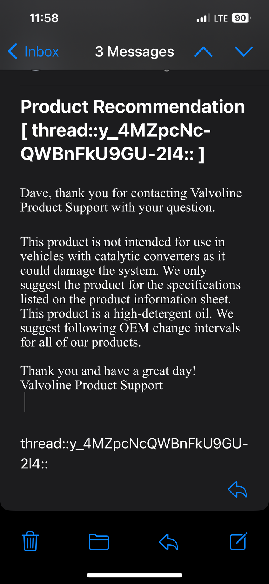

I wrote Valvoline to see what they have to say. I’m on 3000 mile change intervals anyway. Price is fine.

Valvoline states could damage cat. High detergent oil, follow oem frequency recommendations.
I’m giving it a try
