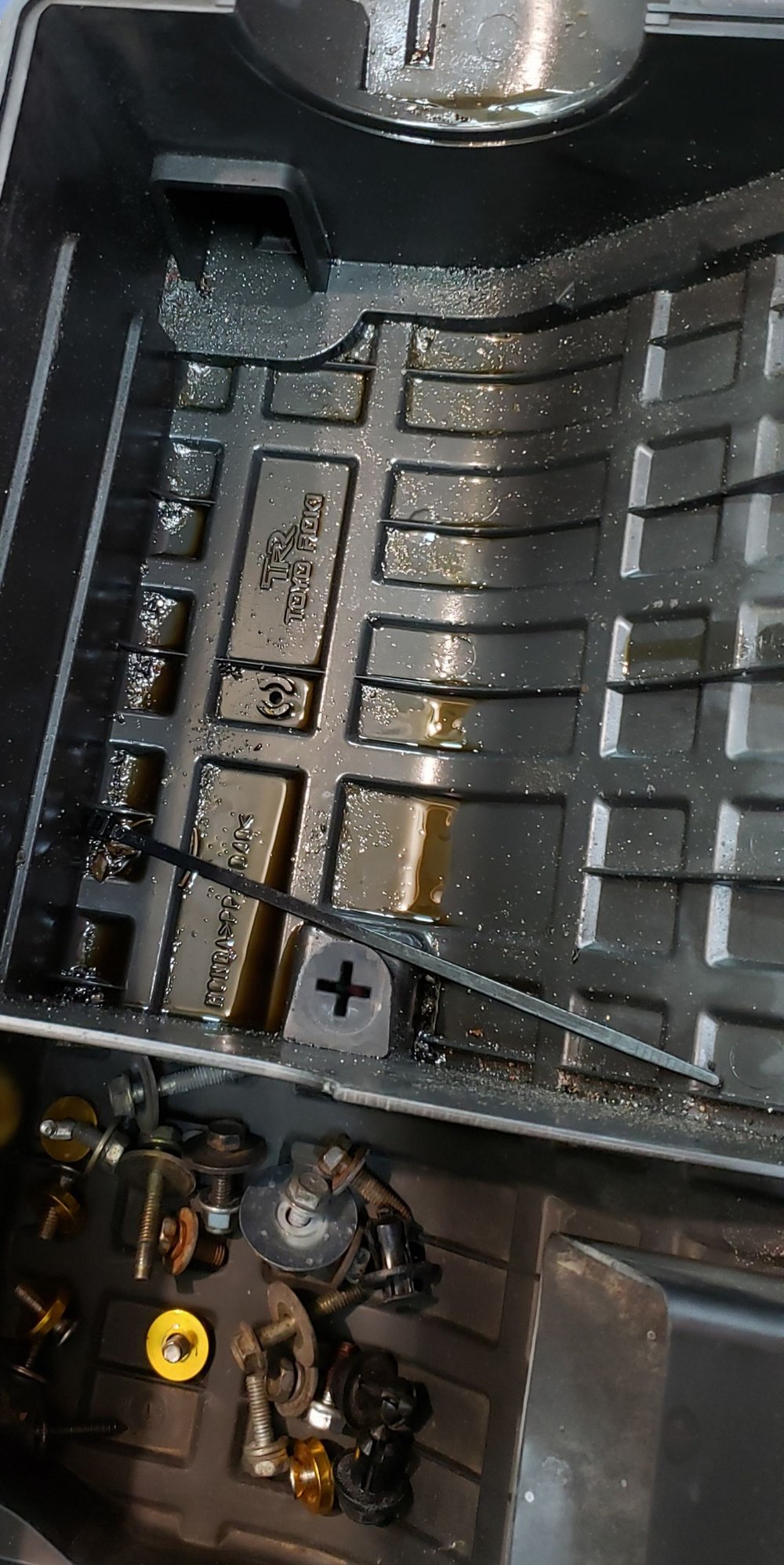

Allowing the smoke screen to happen can cause hydrolock. Definitely more than a nuisance and something you'll want to fix.
I ended up with a bunch of oil in my airbox. This is just what ended up in the airbox. Everything else got inhaled by the engine. That's a ton of oil.
Look in your airbox, op.

back when I had an airbox the only oil I ever saw in there was when I went a little too generous re-oiling my k&n.
On Dayton we ran anti-clockwise (pretty sure that is standard) so the high speed sweepers are left handers. At Road Atlanta the only right sweeper is turn 12, bottom of the hill, just before the start/finish. Didn’t see any smokescreen and no one mentioned anything.
