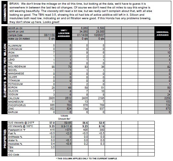

Your wear trends are consistent and favorable so far, no matter which oil you have used. No need to change oil brands, unless you are an adventurer. When you do a valve adjustment, you'll be able to inspect for deposit formation/sludge build-up/varnishing. But I wouldn't expect to see any.
If you decide that you want the best oil you can put in there, then consider AMSOIL ATM or SSO or Redline 10W-30. These oils may help to reduce wear some, but their true potential would be realized through less deposit formation if you are experiencing that problem.

An update. This last one is from a load of Castrol Syntec 10w30. I must've missed filling out the oil interval section when I had it analysed. The total mileage was at 74,672, but the oil was in there a relatively short 4,887 miles. I changed it out when the Maintenance Minder was around 10% versus normally running it down below 5%. Driving habits still the same as before as well.
