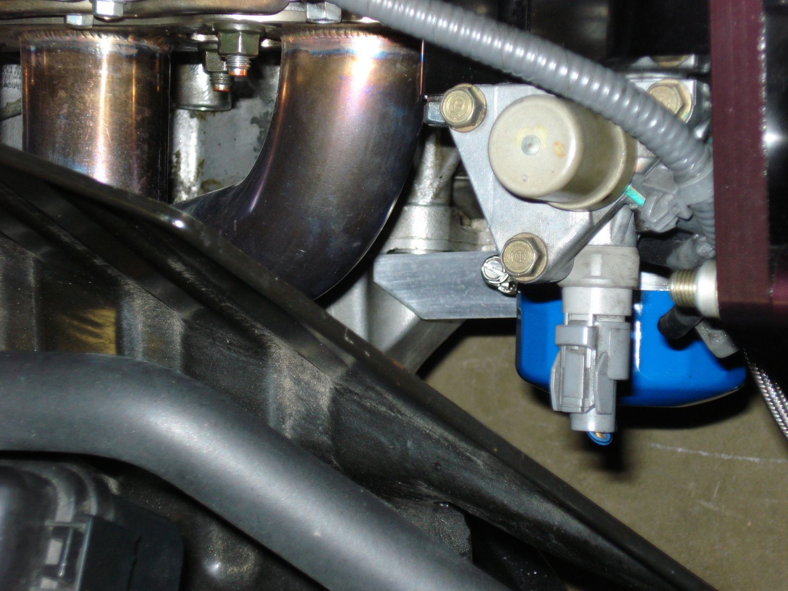

My oil filter backed off and the smoke put the fear in me. It takes forever to wipe the oil off the undercarriage.
I looked at the offering from J's for keeping the filter in place ($60+)
and decided to make my own.
Total cost was $2.60.

hey sideways, i know you do good work, so i am not questioning your ability.
did you use a torque wrench and tighten to 16 ft lbs or did you tighten using the manuals suggested counting method, or did you just wing it?
only reason i ask is because i use a torque wrench and want to make sure i have nothing to worry about. if you used a torque wrench then i need to worry.
advise and thanks for the bracket pictures, looks good!

It was probably my doing.
