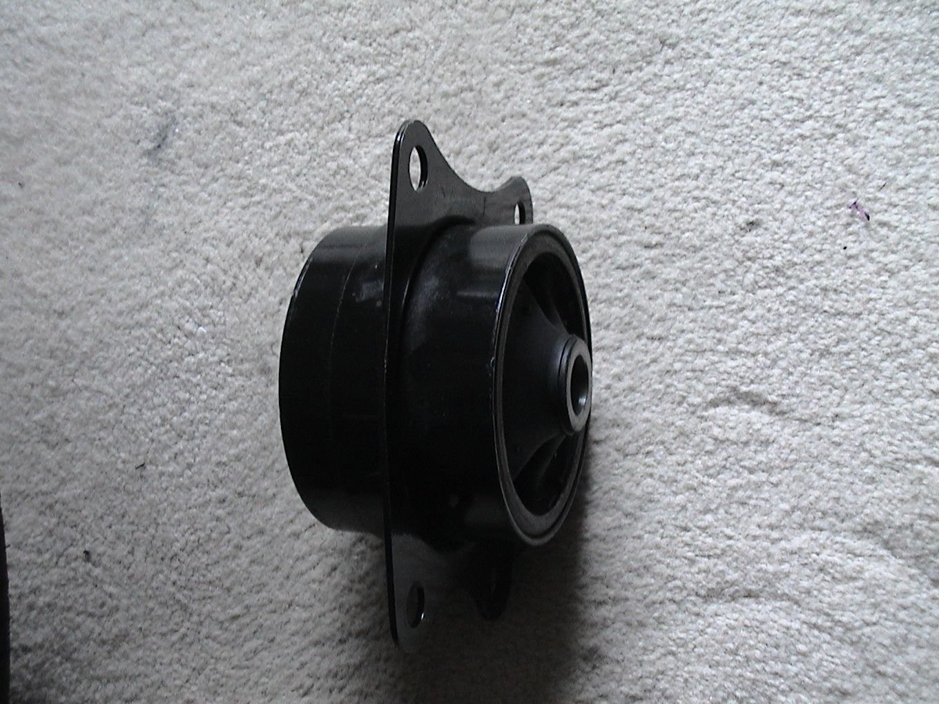

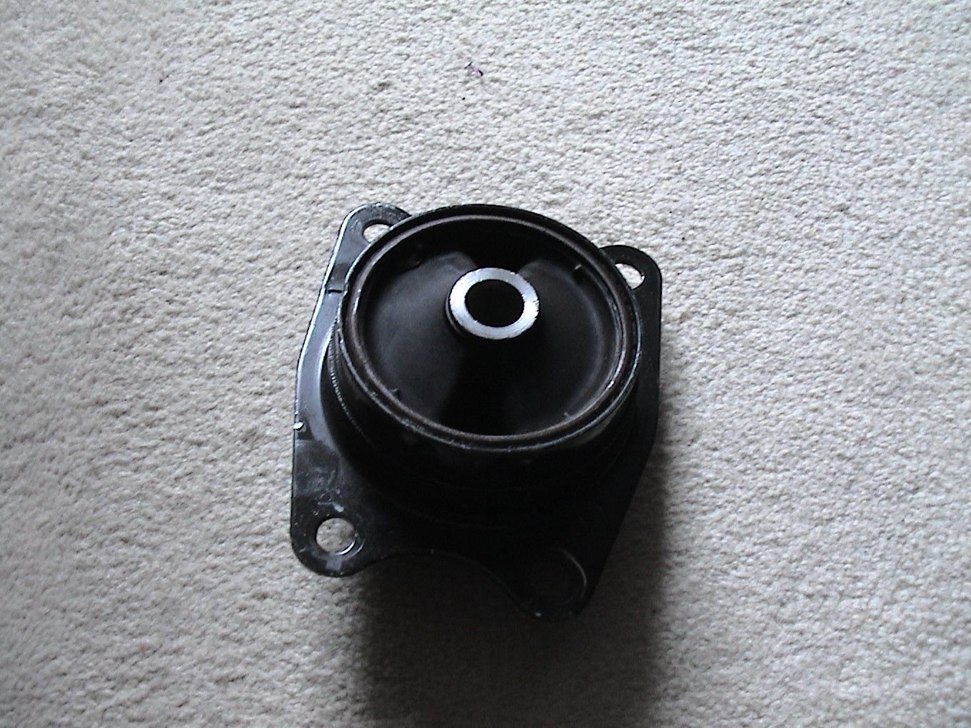

Your differential mounts have a fluid filled rubber part that is leaking. They are mounted in the steel crossmember and contain the bolts from the rear brace
In this photo the bolts on the lower brace are facing the camera and would mount in the rubber mounts that are suspect.
Edited to add the photos of these little buggers that leak oil. Note: They are not interchangable, they are marked R & L

I think sideways nailed it , the two last photos is what I'm talking about . The one on the left side is leaking oil , and yes it only has four bolts . Do you guys know what that parts called or # ?
