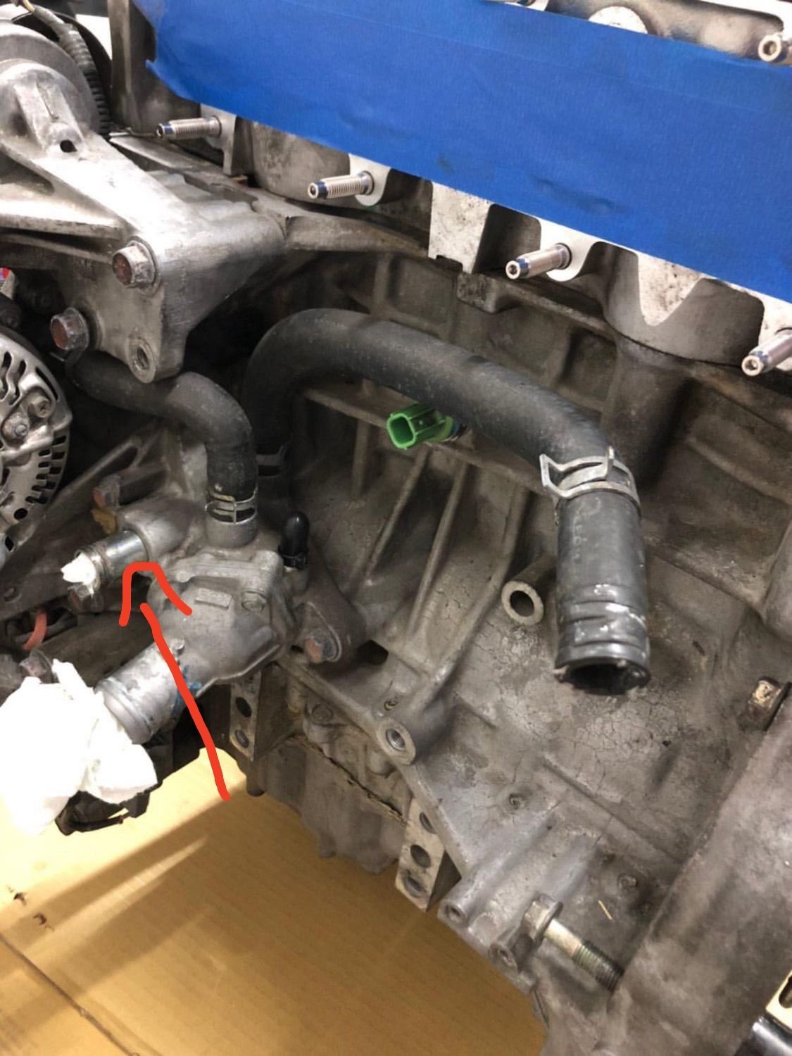

Hey guys, hopefully you guys that have removed your a/c and heater lines can help me out. I just removed all of it and capped the coolant bypass water neck and the inlet on the thermostat housing Instead of making a hose and looping them. Its running fine with no leaks but the temp on the cluster just kept rising to almost max when i shut it off. Anyone else capped these inlets/outlets have this issue? Thanks for the help!

Was the bypass pipe removed? the car will overheat without a bypass pipe and tstat installed. If you really insist on not having a bypass pipe installed, removing you tstat is the only other choice.
