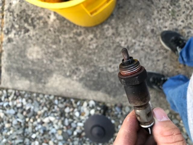

second sensor on cat is pulled out of stream due to 70mm test pipe. Removed o2 bungs today because they were rusty and falling apart, put sensor back directly in stream... oem sensor is legit a little nub? Never seen this before. Looks aftermarket? Attached picture below on this. It prob won’t even see the stream after threads in because it’s so shallow. Idk but don’t think this even has anything to do with this code anyways???

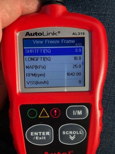

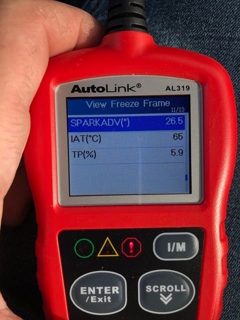

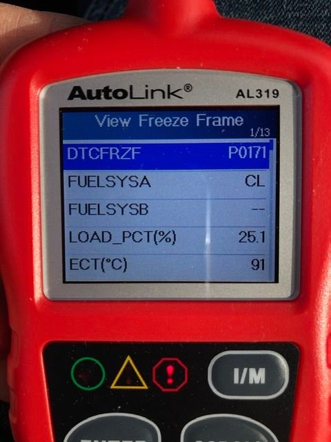

ive taken some freeze frames off obd2 scanner from today’s reset when it threw the code today, been resetting it every time I try a fix. I have a basic reader nothing special. Also is the downstream o2 sensor I had mentioned in the cat.
