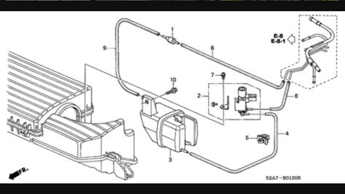

Old Aug 23, 2021 | 07:24 AM
Billman250's Avatar
Active Streak: 30 Days
Active Streak: 120 Days
Top Answer: 1
Posts: 22,389
Likes: 1,842

Old Aug 24, 2021 | 10:23 AM
engifineer's Avatar
Joined: May 2014
Posts: 7,919
Likes: 2,489
Lines 6 and 8 are very commonly left off by accident , and the way they lay they can lay right next to the metal lines and not be noticed. I would start at those two, where they connect to that pair of metal lines
Old Aug 25, 2021 | 08:13 AM
apextc's Avatar
Joined: Jun 2017
Posts: 43
Originally Posted by Billman250
There is a vac line routing diagram sticker on the underside of the hood. Follow it.
I promise yours are crossed or disconnected.
THANK YOU AGAIN FOR ALL YOUR EFFORTS FOR THIS COMMUNITY. Somehow, this was disconnected.
Reconnected it, cleared CEL and been driving it like i stole it since I only get a few months here in Chicago
