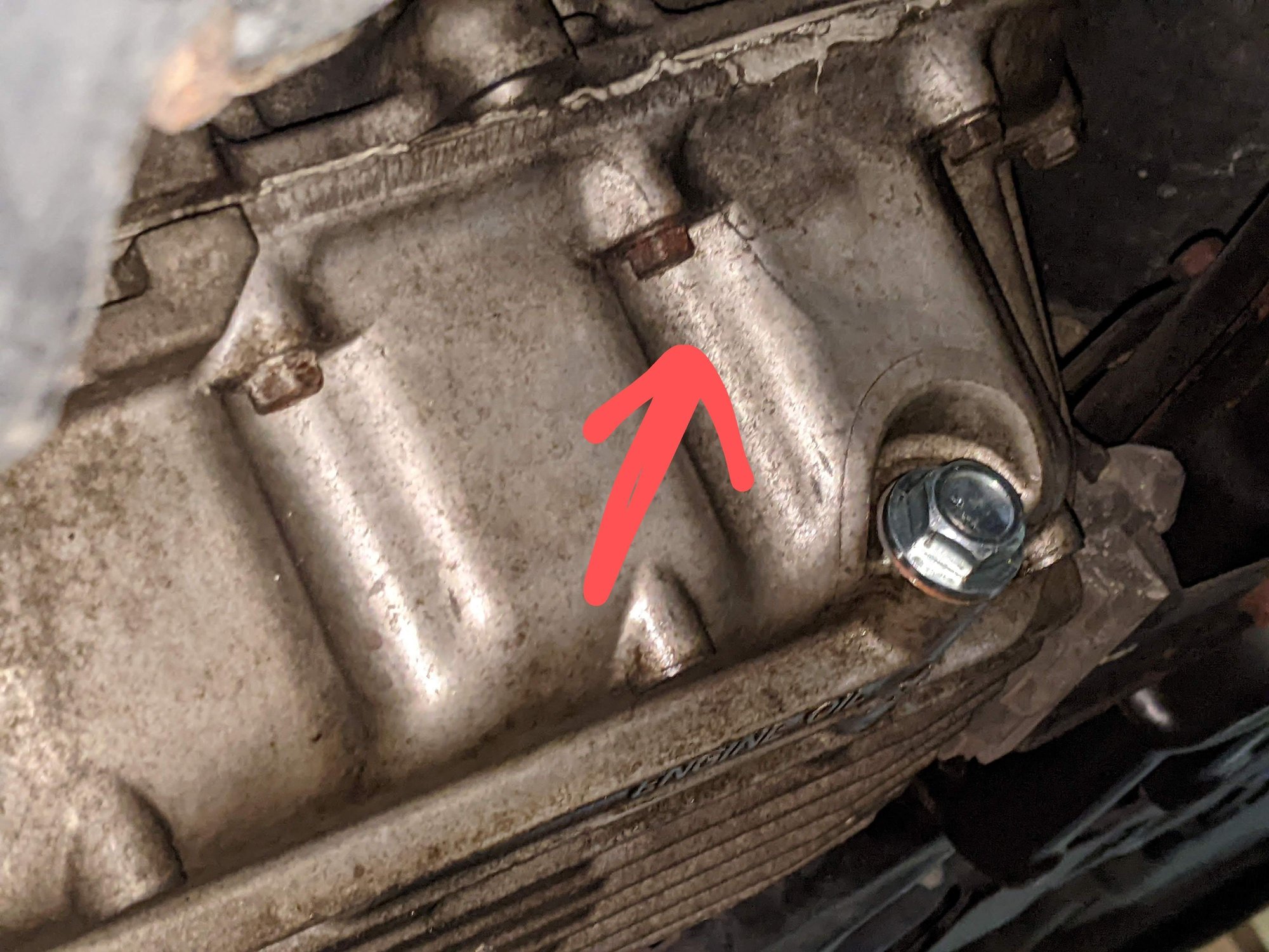

So… I solved the coolant smell mystery. Turns out I’m an idiot and didn’t recap my coolant overflow hose after filling my coolant reservoir. Staying true to my username I suppose.
This doesnt really answer the white smoke issue, however. I checked the oil dipstick and it’s full. The ground has a couple of drops of oil located below the area where the oil pan and transmission mate. I did spot what might be a crack or stress fracture but it’s not actively leaking from that point.
I also noticed that there’s oil present on the area between the head and the valve cover closest to the firewall and the exhaust manifold. Could the valve cover gasket be the smoking gun? I did just installed a new gasket relatively recently. I bought some UV dye that’ll probably help me with troubleshooting this a little more.

That looks like casting marks which is perfectly normal.
Try and clean the engine as much as possible as it will help a lot finding any leaks, that valve cover gasket seems very likely though.

Concur casting marks, normal.
Concur likely to be valve cover gasket leak. Might as well do valve adjustment while in there.

One may think that the oil is leaking from the oil pan. But, prolly the air passing under the car --- while in motion --- is drawing oil from the leaky valve cover down to the pan.
