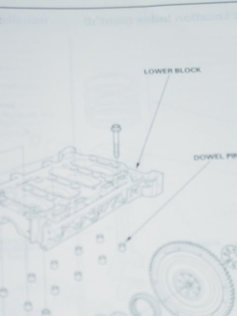

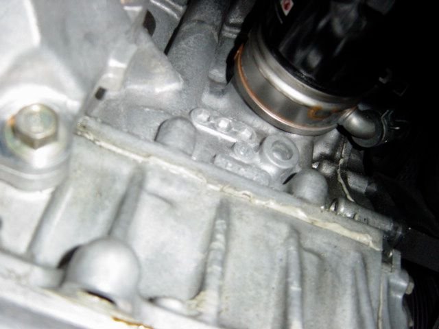

Old Aug 12, 2007 | 07:09 AM
DEIGER's Avatar
Posts: 1,689
From: Charlotte

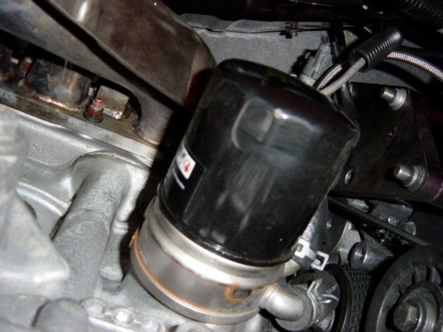

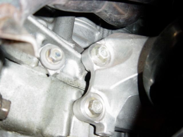

First pictures are to confirm that I am using the right words to describe the engine block.

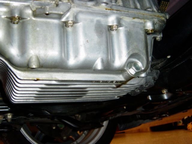

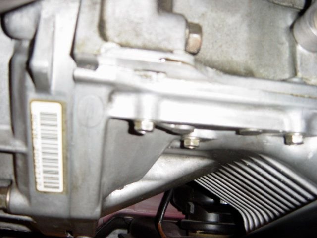

The residual oil is more noticiable on the seal of the oil pan and lower block. Also notice the oil plug. However, after the test drive I noticed oil first from the seal between the lower block and main block and then a "river of sorts" runnning down to the oil pan and then to the oil plug.

Old Aug 12, 2007 | 09:59 AM
Stratocaster's Avatar
Posts: 11,399
Likes: 19
It does look to me that they did remove the girdle. The sealer looks to be tattered.
But the oil pans seems to be the source of a leak, at least from the pictures.
To fix this right, you are going to have to remove the motor from the car. Install it on a stand and take it apart. From what I understand, sealing that area (girdle) effects the main bearing clearances so don't go over board with the sealer.
Old Aug 12, 2007 | 10:07 AM
DEIGER's Avatar
Posts: 1,689
From: Charlotte
That is initially what I though, however upon initial idle and a little driving it started to seap out of the upper seal of the girdle. Being the cautious person I am, I was considering removing both parts, cleaning, resealing, and reinstall both parts. I did notice that removal of the girdle requires the removal of the the two engine mounts. I assume the engine is supported by more than these two mounts, there by not requiring an engine hoist. Either way I believe I am going to call on a professional to undertake this.
Sideways, believe me that was a consideration. The oil level does seem to be affected for the min. 3 months or 3,000 miles. But it would bother me that it was leaking. Also curious if there is something else wrong I am not seeing.
If anyone can recommend a good, professional mechanic within 50 miles of Charlotte, please do so. Quality vs. convience is what I am looking for.
Deiger
Old Aug 12, 2007 | 11:26 AM
Slows2k's Avatar
Posts: 45,374
Likes: 429
From: Mother F'in TN
I'd clean everything off 1st, with non-cholinated brake cleaner. Make sure the entire surface is oil free. Then get some spray on foot powder and spray every seam from the girdle and timing chain case. Start up the engine and look for where to oil starts to show 1st on the powder.
I'd be more suspicious of the oil feed hose for the SC, the VTEC solenoid bolts being loose or broken or the timing chain case seal being the cause than the girdle.
