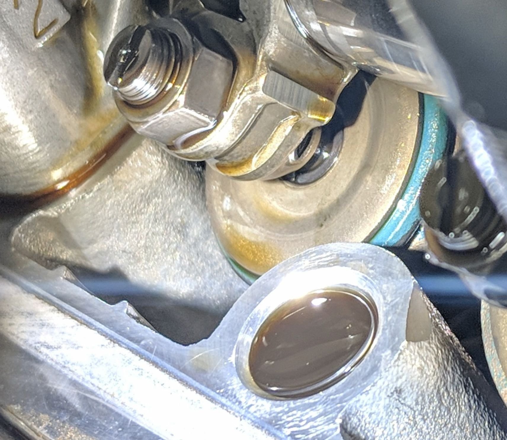

Hello all. Just picked up my first Honda. I hear I should assess the shape of my retainers, since it's an AP1. Spent more time taking pictures than pulling the valve cover...
From search, it seems that I should be looking for recessed keepers, and I think I'm not seeing any, but I'd appreciate if someone with a trained eye could look it over. I could retake a few since the cover is still off, waiting for the valve adjustment job tomorrow.
Thanks!
Single valve pics - exhaust side, double - intake.

They look fine to me. Interested to see what others think.

Camera angle needs to be lower, to view the inner wall of the retainer. From what I can see all look good.

Thanks.
Trying to take these made me appreciate the effort people put into decent DIY guides even more. No way I could get my cell phone in there even lower while holding a flashlight. Maybe if I removed the fuel rail/battery heat shield.
I plan on upgrading retainers over winter anyway, just want to make sure it's not about to drop a valve.
