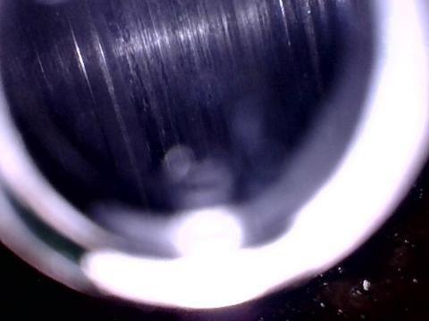

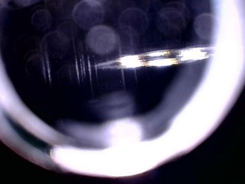

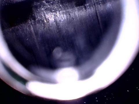

Engine has scored cylinder walls. Been told it needs to be rebuilt. If unable to be honed, understand it will need sleeves. Any suggestions for which sleeves to go with? Do the sleeves last?
Thinking about sending the block to Inline Pro. Anyone had them sleeve a block?
From borescope
