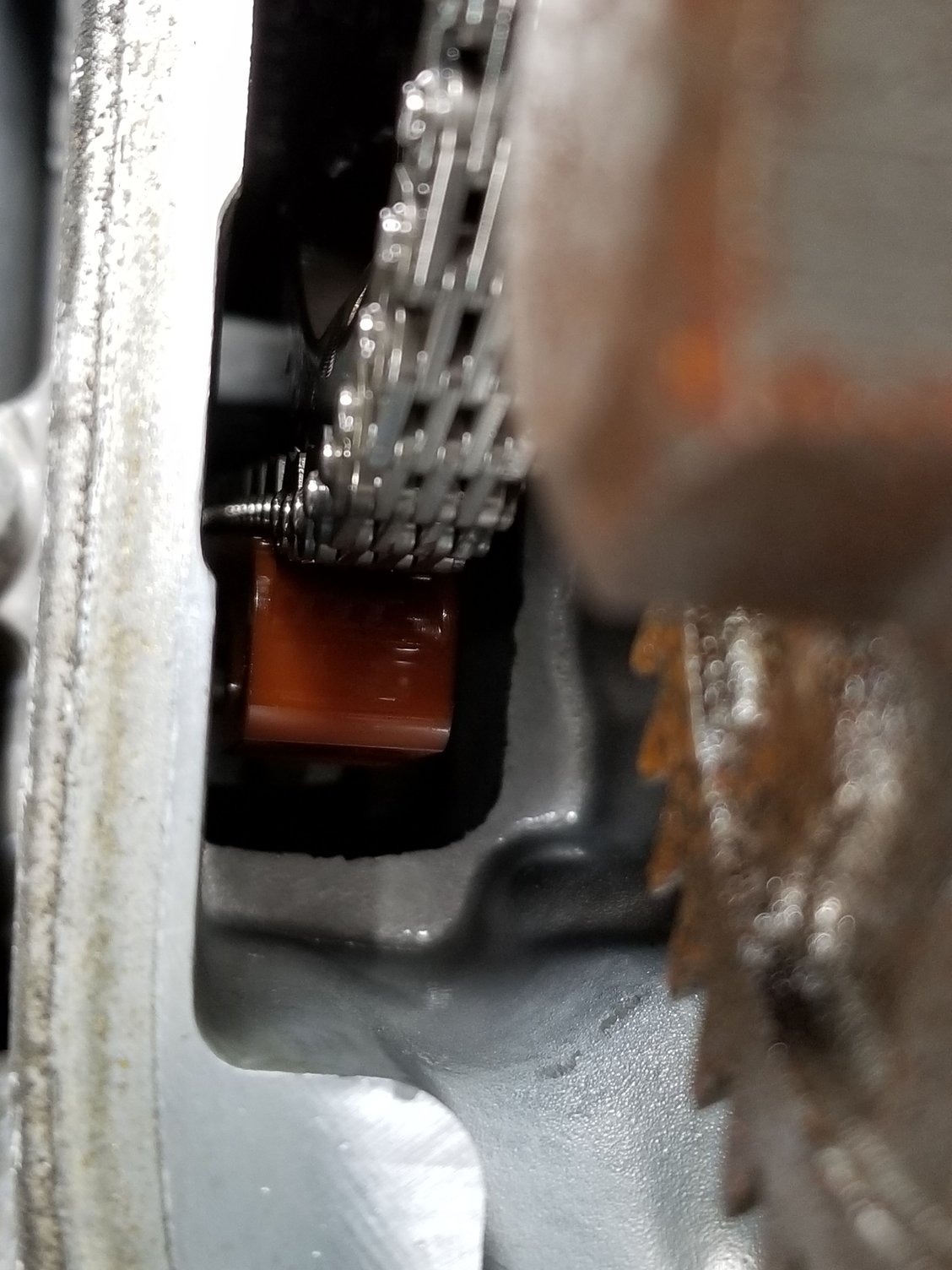

Intake side of the chain, the grooves on the block seem better than the exhaust side.
Not sure if this is normal, but on the timing chain side by the exhaust, if you look closely there seems to be chunks missing or damaged. Can't tell if this is normal.

That looks nasty. My thought is engine sat unused for a very, very long time. Oil flowed down from higher points, exposing those to air, and eventually rust. Lower areas still had oil coating, so no rust.
That cam gear photo seems to back this up. Its only got rust on one side. That side must have been facimg up.
The real fear is if this was caused, not by air, but by water. As in car was in a flood. Any othet warning signs of that? Moldy interior smell, or all new interior?

You have two options, run it as is and take the risk of rust being on a critical surface and causing the engine to fail OR rebuild the engine.
I think I would drop the pan and inspect the bottom end, that will give you a better idea as to if this was a flood car or a car that just sat too long. If the bottom end looks good I would pull the head and have it rebuilt, I would be afraid that something is going to fail in the head and damage the whole engine.
The thing in his the labor involved in dropping the pan and pulling the head is only slightly less than pulling the whole engine. Just my $.02
