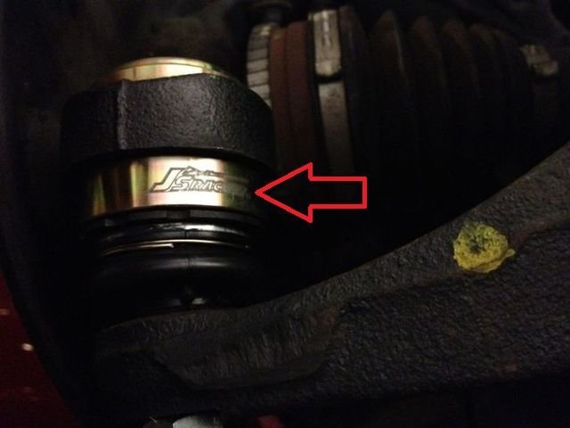

Yeah I removed the C-Clip. The only thing that I could possibly see being a problem is Megan Racing provides a metal ring as an insert for the taller clearance and the C-Clip goes right under it. I left the metal ring because I can't take it off but Im starting to think that maybe it needs to come off?
The metal ring right above that C clip. I can't just slide it off. It was pressed in also so I'm not sure how to take it off besides maybe grabbing some pliers

Another example. I thought if press it out it would just slide out from under the metal ring. Maybe that is holding it in?

You should be pressing/pushing on the ball joint housing. It will slide thru the ring and spindle.
Were you hitting on the ring? or the housing?
