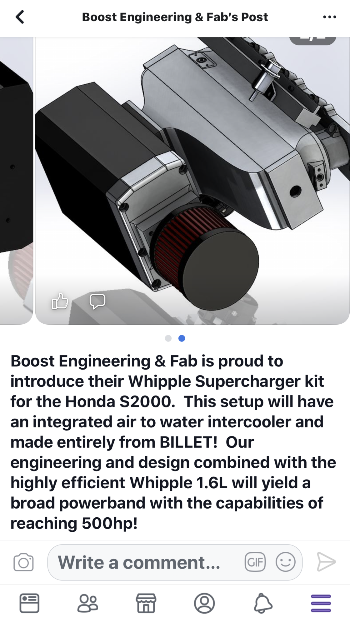

IMT is working on a TVS 1320 setup. Should be around some time next year.
Also this:
Keep a lookout.
