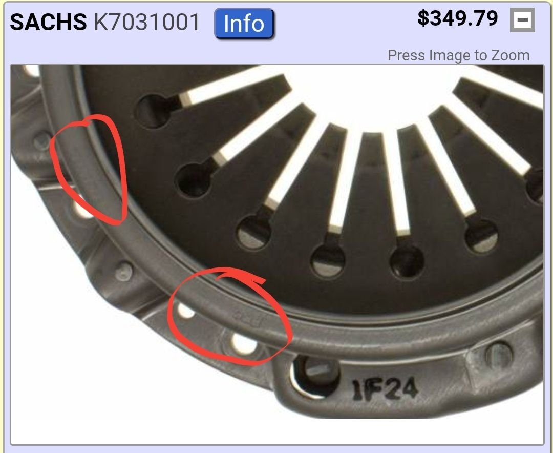

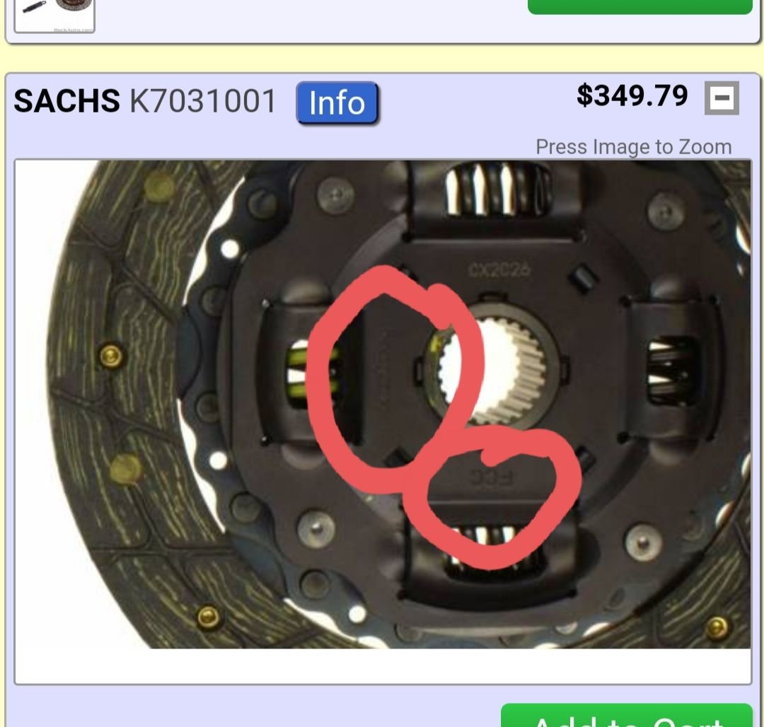

I've done a couple clutch jobs and reused the OEM plate. I refinished them myself with a drill and polymer/ceramic paint strip disc. Someone "LOL'd" at me for this idea in the past. But...read below.
Rockauto has sachs clutch kits that appear to be the same design as OEM. They're almost for sure not the same as a dealer part. But the OEM design does seem to allow them to work. I think they're around $350ish.
Be careful. Sachs and other manufacturers just source the parts and sell them it seems from (Idk what suppliers).
So make sure when you get your parts, they're the same design as OEM. The plate and disc should have a "Honda" stamp and the disc should have enclosed springs. This likely means that the manufacturer either copied the Honda stamping die OR is using Honda cores to remanufacture and sell as new.
Here's some screenshots from rockauto. Just make sure the parts you get match up with these features. Note the enclosed springs too.
They carry other brands that have similar parts too...
This one notes "flywheel spec +0.059". IDK wtf that means. Maybe that the PP is machined up to 0.059" from original. Which again just fortifies the theory that they are reworked, used Honda cores. Someone sends in a OEM core. These blokes clean, refinish, and resurface them. Who's LOLing now?
