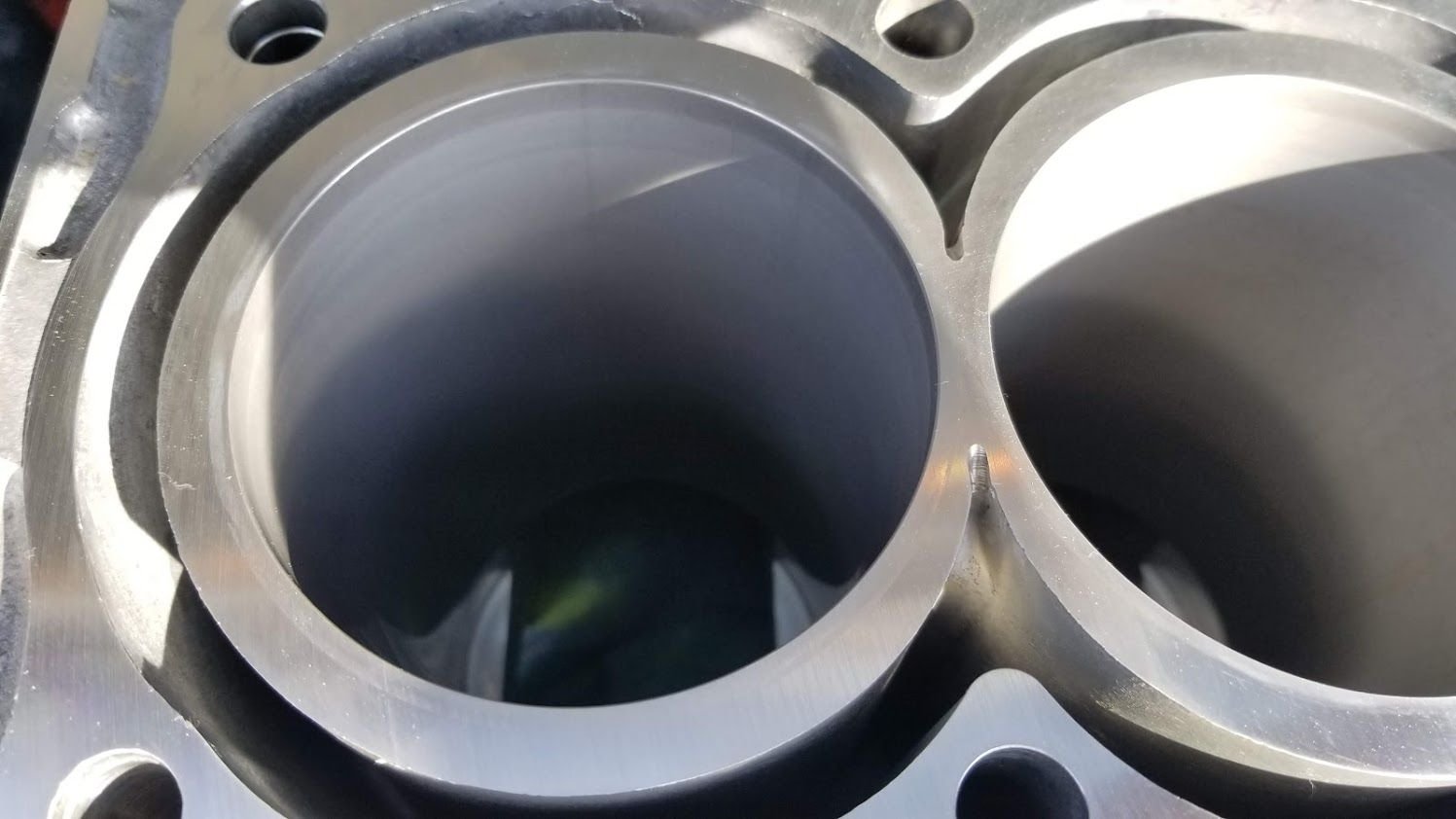

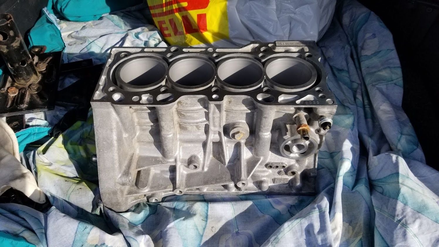

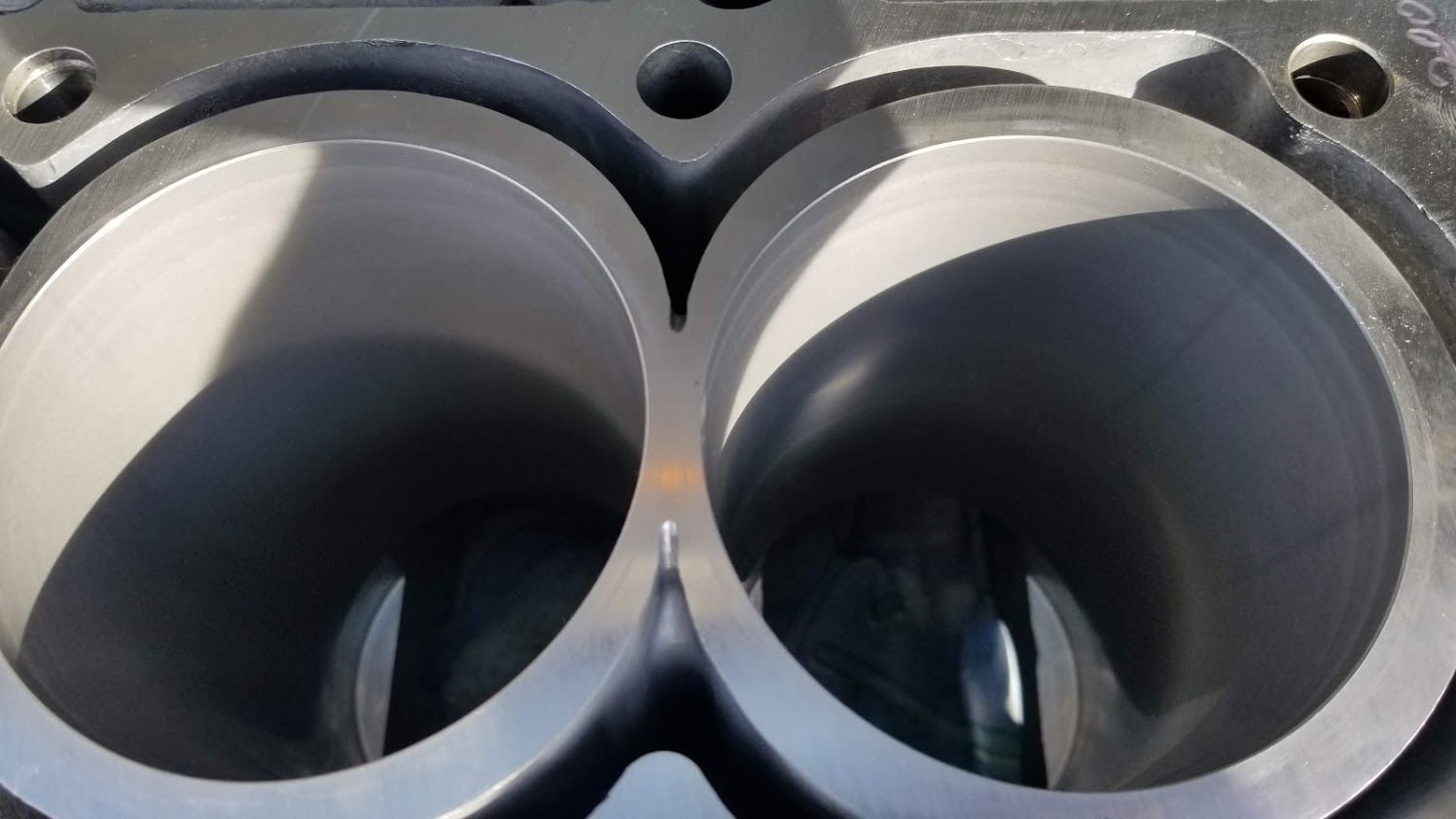

Thanks for all the input. When I say I'm getting the block honed, I'm just asking for a simple light deglazing to seat the rings. No more.
As for decking the block, the shop is quoting $60CAD to give it a skim. I'd rather go that route vs risking creating any low spots with a sanding block/whetstone. Besides, by the time I spend the money on a whetstone the width of the block and count my time spent smoothing the deck, it'd be hard to argue against a properly setup machining center giving me the best flatness.
The shop is well known locally for rebuilding F20/22c engines so they do know what they're doing and have the proper stones for deglazing.
Since the block is out of the car and I won't want to redo this job, I just want it done properly.

Just an update for anyone interested, Gord Bush Performance skimmed the block, only needed to take 0.002" off the top, guaranteed flat with a good gasket surface now. The honing process results also look fantastic. Waiting on parts now to begin blueprinting before reassembly.
