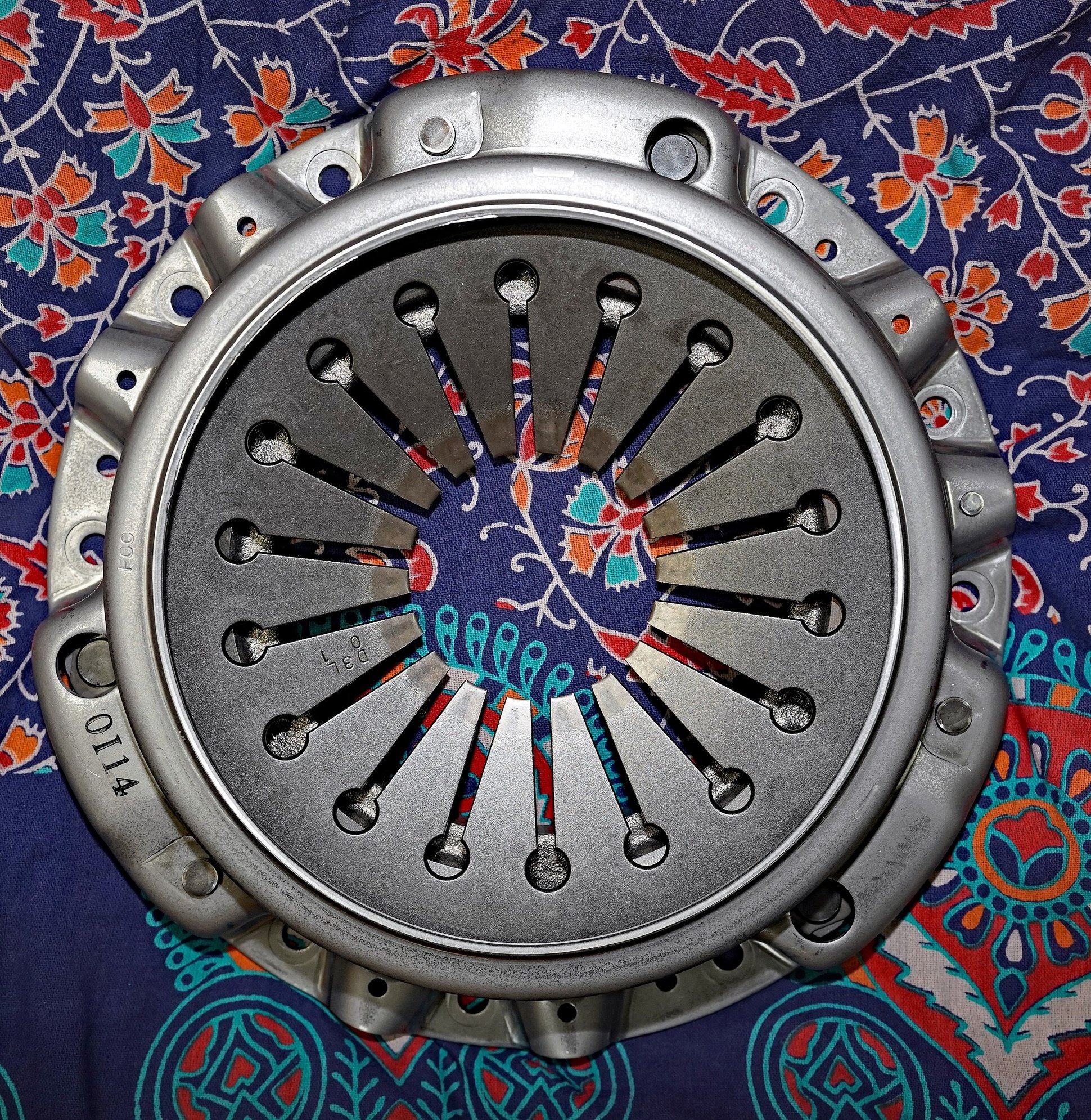

I would start by draining the oil into a clean drain pan and checking for metal flakes/chunks. You could also pull the vtec solenoid and check the screen for flakes.
If you don't find flakes then its probably safe to assume there is something up with the clutch or something that was removed when the clutch was replaced. I wouldn't think you'd get a thrust bearing failure in only 320 miles with that clutch so hopefully it was just an install error or a bad clutch.

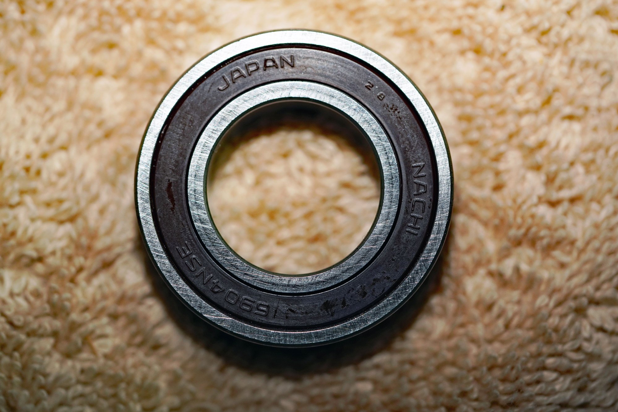

This is too bad. May need to go back in and change pressure plate and replace pilot bearing. Use an OEM pressure plate. I replaced the original pilot bearing with a Nachi made one. Smooth as silk and very quiet.
Pressure plate should be made by FCC.
