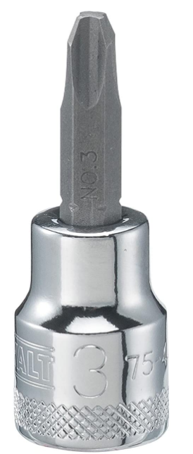

I like to use a 3/8ths socket PH3 bit.
With a ratchet I can get plenty of leverage while also pressing the tool towards the rotor so the bit doesn't strip out of the screw head.
If that fails, I drill them out.
phillips head bit might work but it's better to use the right tool for the job imho

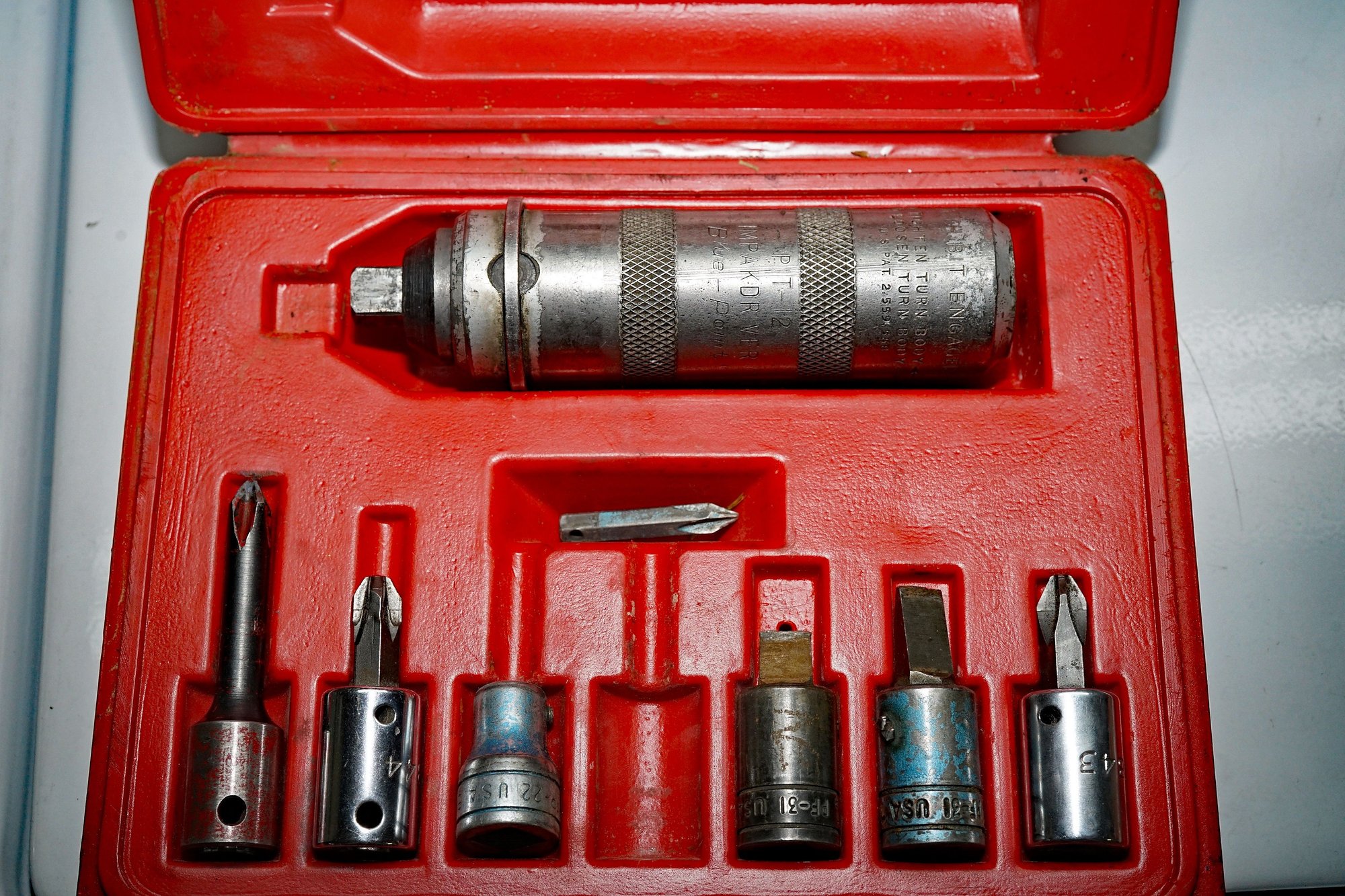

Yeah, the screw is prolly put on to keep rotor on hub, while on assembly line. I reinstall them, just of sake of completeness.
This little kit has always worked for me.
