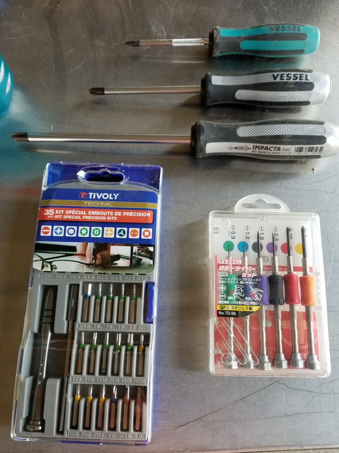

I also have the Vessel drivers along with a Vessel kit for smaller stuff. The two larger of the Vessel drivers are one way impact drivers. I also included in the picture a Tivoly Technic kit of a variety of specialized drivers. Got it in Paris but have seen it on Amazon. Not so much for major engine work but has come in handy for a lot of other things.
