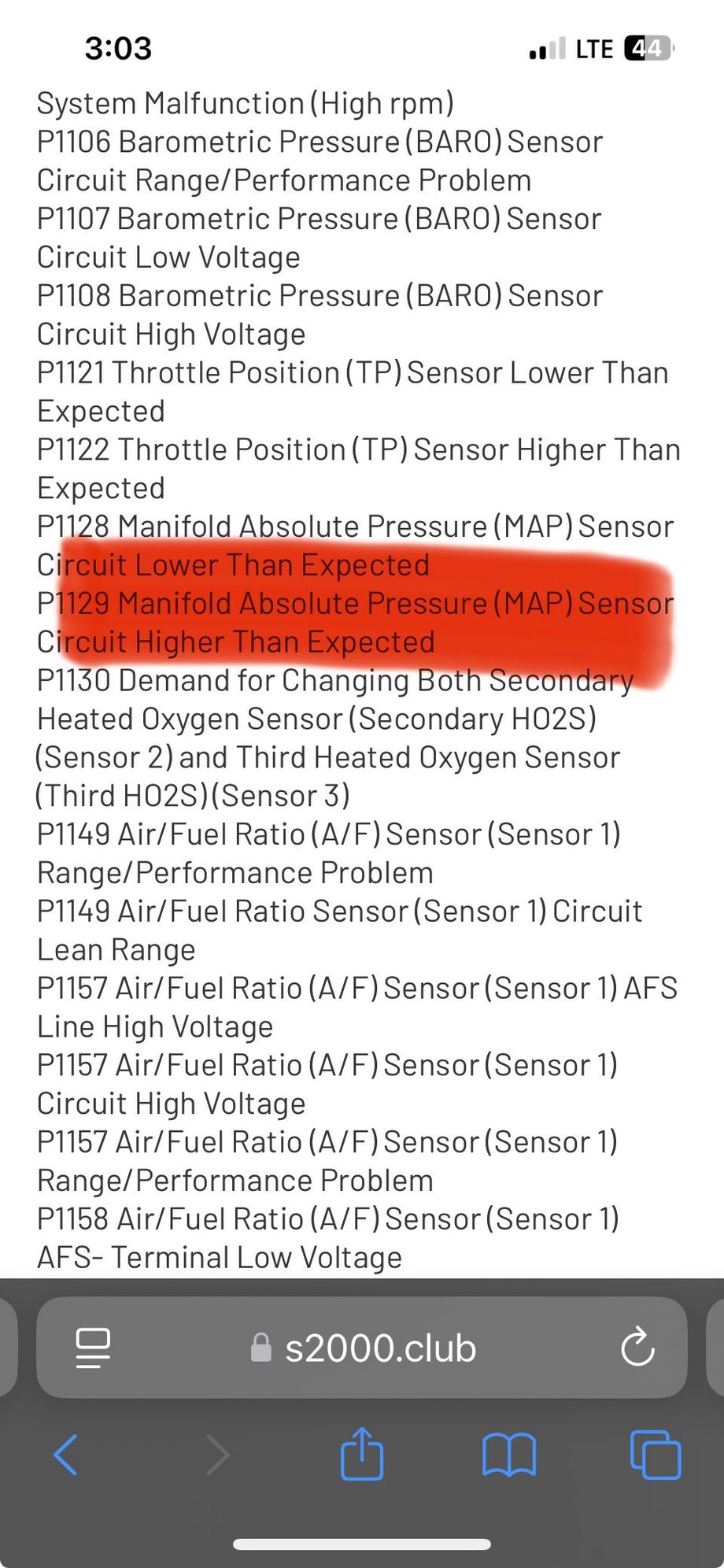

Car started running really rough and eventually died on the road. Good news was I was 100yrds from the shop. And I got a code! P1129 which I looked up as MAP HIGHER than expected
Engine just felt like I was running out of fuel before it died. I still have 4 bars of fuel left.
im just going to leave it here until we can get it fixed.
