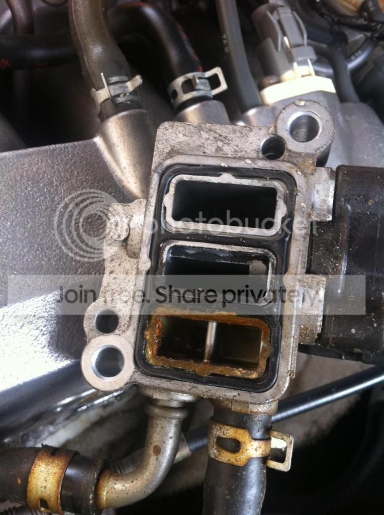

Hey
I was cleaning my IAC yesterday to my surprise i found rust around iac where the coolant flows it. Theres only alil bit thats actually inside the area but the surrounding area of that spot is pretty much rusted as my this pic shows. . .
Any idea why and should i replace my iac?
thanks in advance

You should flush your system and put in 50/50 coolants. More water in the system is what cause the rust.

should i clean up the rust or replace it as well? its only around the gasket area though

Yeah looks like you are running it with too much water mixed or no coolant at all. I wouldnt worry about replacing it because of that, id worry about everywhere else the coolant runs through looking the same (engine). Definitively flush it out asap. Seen a lot of probablems occur with just running water.. I have no idea why anyone would do that.

sand down and clean the rust off the IAC and re-use the part.
You could have an air pocket in the cooling system, but if your anti-freeze is in really poor condition you could have a clogged heater core too - scale. Stick with Honda coolant it works really well even when left in the system too long.
